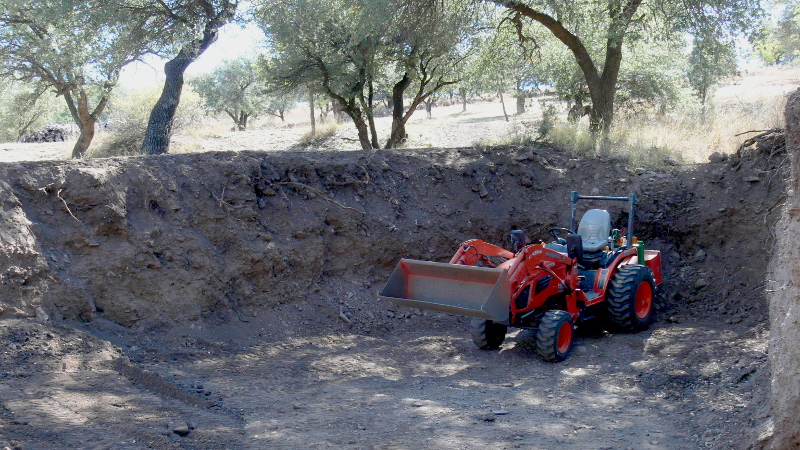

Something like this? Hard rocky soil in a dry creek bed.
