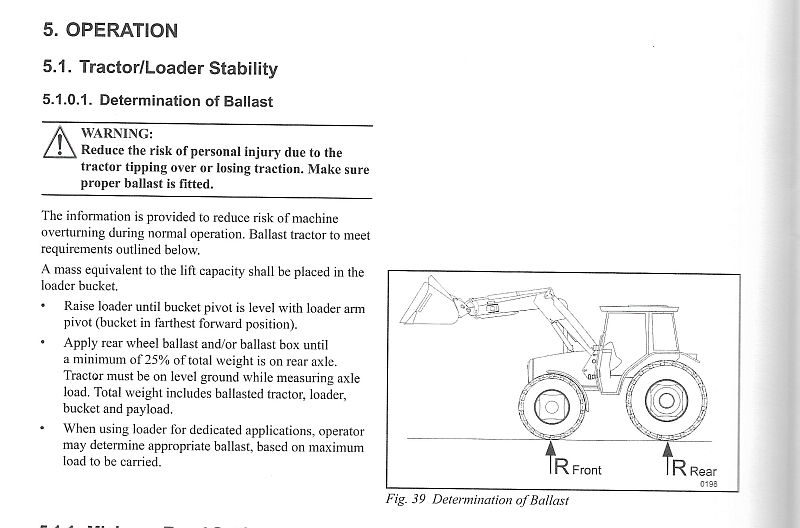

It's become apparent that I need some ballast on the back of my tractor as I now have a grapple I'm using. The question is, how much ballast? My tractor is a Branson 3725. 37hp and just over 4000 #'s dry weight. What would you suggest?
I plan to use a carryall and put the weight in a 55 drum.

Make sure drum won't fall off carry-all, 1200-1500 lbs depends on how much weight are you lifting?
I like to use loaded tires - weight always on tractor.

With air in your tires I concur that 1,200 to 1,500 pounds will be enough counterbalance.
Your Branson is about the same weight as my Kubota L3560. FEL lift is a bit more. I have air inflated tires too.
Make sure drum won't fall off carry-all, 1200-1500 lbs.

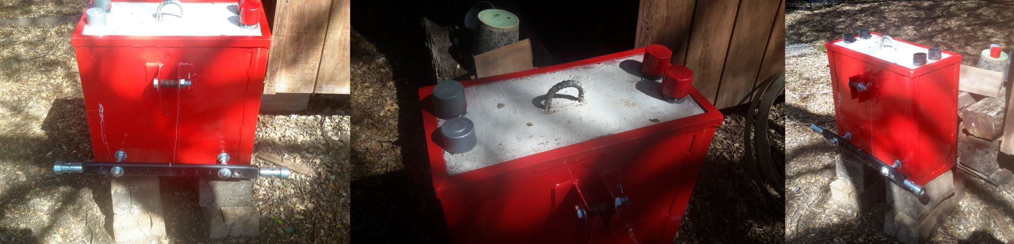

Concrete weighs in about 150 lbs per cubic foot, I made a 4 cubic foot box for my SCUT and its at about 600 lbs (-/+) and make front a bit light with FEL empty... But when doing FEL work it seems ok.... I know lot smaller tractor, but....
Here is what my tractor manual has to say about ballast...
