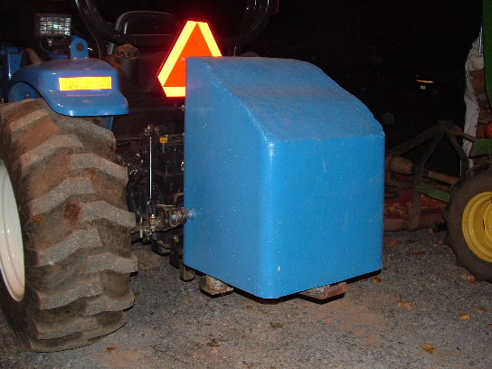

Here's a photo of the ballast I made for my TC-35. I used 12-80LB bags of quikcrete concrete mix. I used an old cherry picker fiberglass bucket as the mold and welded my lift arms and pedistual all together and poured the concrete in the mold. When it was setup I took the loader and flipped it over and popped it out . After letting it set for a week I coated it with concrete sealer and painted it. I have no problems anymore with the tractor getting tippsy with a full bucket. /forums/images/graemlins/grin.gif
Bernie

I was reading this post and it made me think, I only use my rear blade for back weight. Could this be why I do not seem to be to push though a lot of gravel or wood pile. it seem like I can pick up a load of gravel fine. Hard sevice is what I am on.
Hum green tractor owern. newbee. that is.
4110 jd and 410 loader. No weight in wheels.
Thanks
roge.r

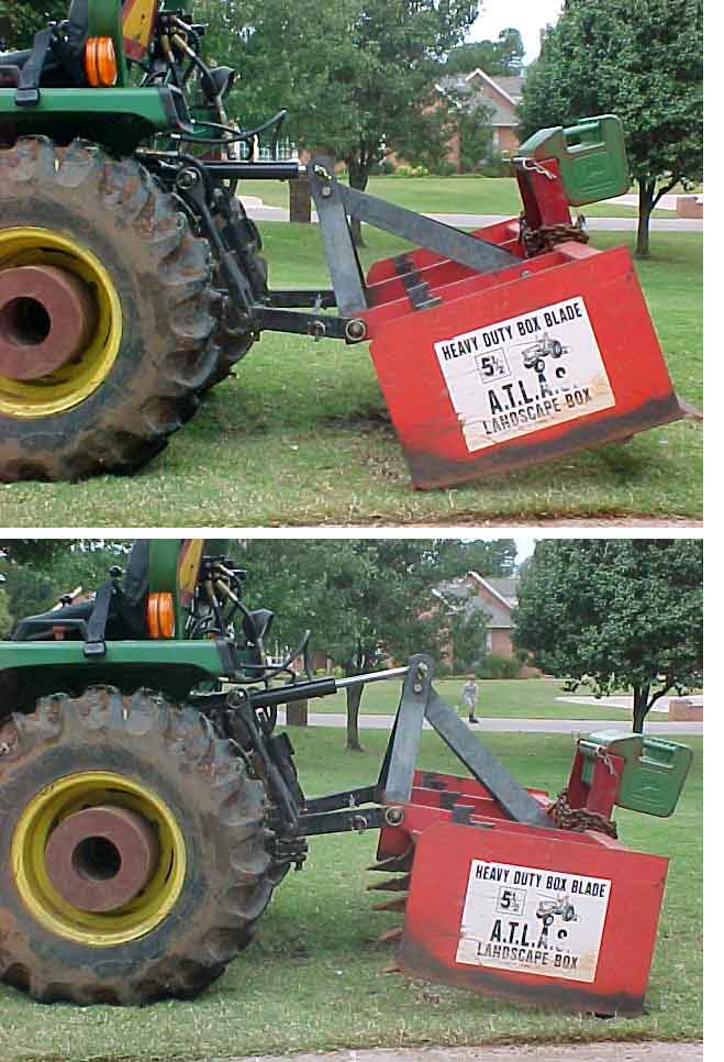

Like roermo and Roy, I use an implement (box blade) for FEL ballast. A home built rack welded to the boxblade to hang a few suitcase weights makes the boxblade an even better counterweight. The suitcase weights make the boxblade work better, too.
If you don't have a boxblade, you will find a use for one, and it might serve you well as a functional ballast box to boot.
This picture was taken to demonstrate range of motion with a hydraulic toplink, but the rack and weights are easily seen.
OkieG

Loader fork lifting is what needs ballast the most for my tractor play. Although the boxblade is not real apparent in this picture (the red spot by the right side tires), it is working well as I try to move a tree around.
OkieG
