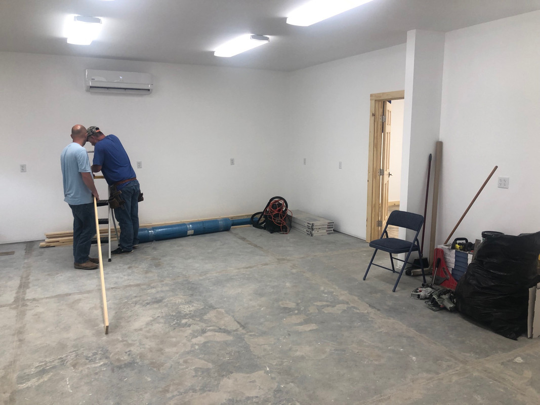

   / How much cooling power can I expect from a mini split ac unit? #10
I am just finishing up my 28' x 38' (9' ceiling) very well insulated shop that consists of three rooms, 24' x 28', 14' x 12', and 14' x 16'. All rooms are cooled/heated from a single mini split head in the larger room. So far it's only got into the low 80's but just running it continuously in low "dehumidify" mode (not even "cool") gets it too cold so I have to turn it off or change to cool mode with the temp set at 73 or more. So yes I believe a single head mini split will do a great job for you. Mine is a Carrier (I don't have the models of the outside and head units handy) but professionally installed.
