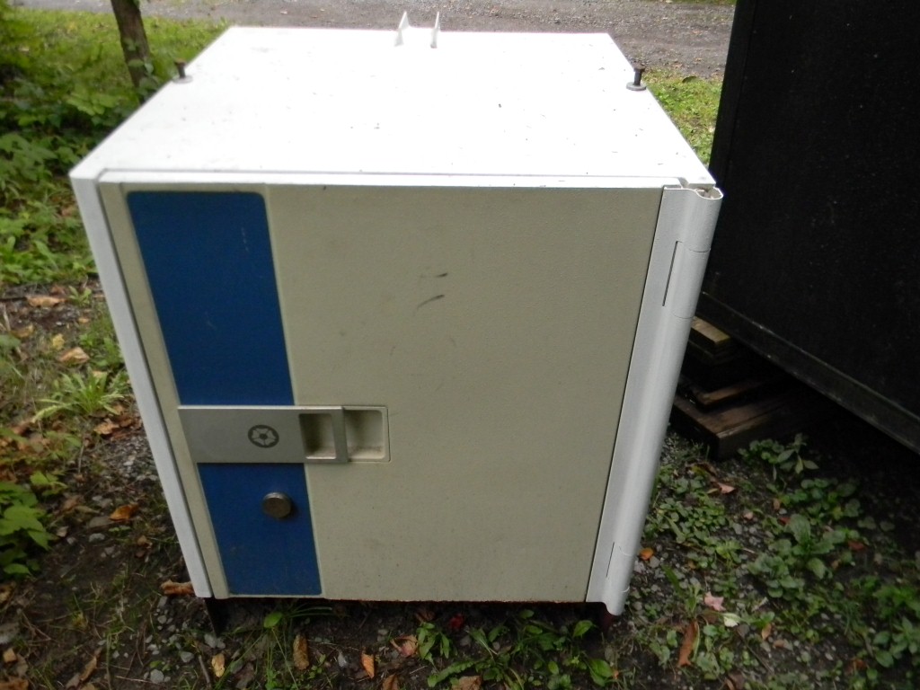

Using my bucket for snow I don't use any 3 pt. weight but I do have the rear tires filled. Using the loader for dirt or stone I use a 3 pt. cement filled barrel (about 900 lb) or I can use an old safe I put brackets on for a 3 pt. weight. That weighs over 1200 lb. I'm going to buy a digital hanging crane scale shortly so I'll have a more accurate way to measure heavy weights.

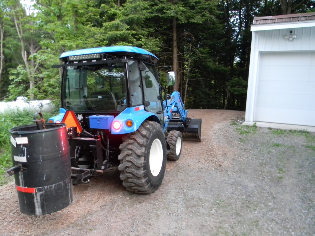

Just built mine out of 55 gallon plastic drum. Took 16-60lb. bags. Added some pipe for shovels, rakes, etc. Also added two eye bolts for lifting other than 3 point hitch. I have the XR4046H and it made the tractor a lot more stable. I did not fill my tires because I do use it in my yard a lot and just do not want any issues with rims later in life. I did not want to spend a lot of money on implements that had enough weight to make it worth while but did not need so I made this for under 100.00. Hopefully the picture comes thru.
