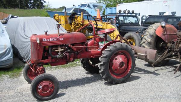

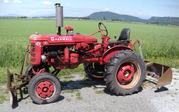

Can anyone tell me how much wheel weights weigh for Cubs and Super As?
I'll try to upload a couple pics. I need to know so I know about how much the tractor weighs for shipping

I bought two of the rear wheel weights last year from a tractor junkyard. The owner told me they were 140 lb. each. Being curious I tried to weigh one on an old bathroom scale and it was about 135 to 140. Mine were rusted pretty bad but they had numbers on the weights. Unsure if they stated the weight. Hopes this helps
   / How much do wheel weights weigh? #3
Rears weigh 145 each, fronts 42.5 lbs each.
