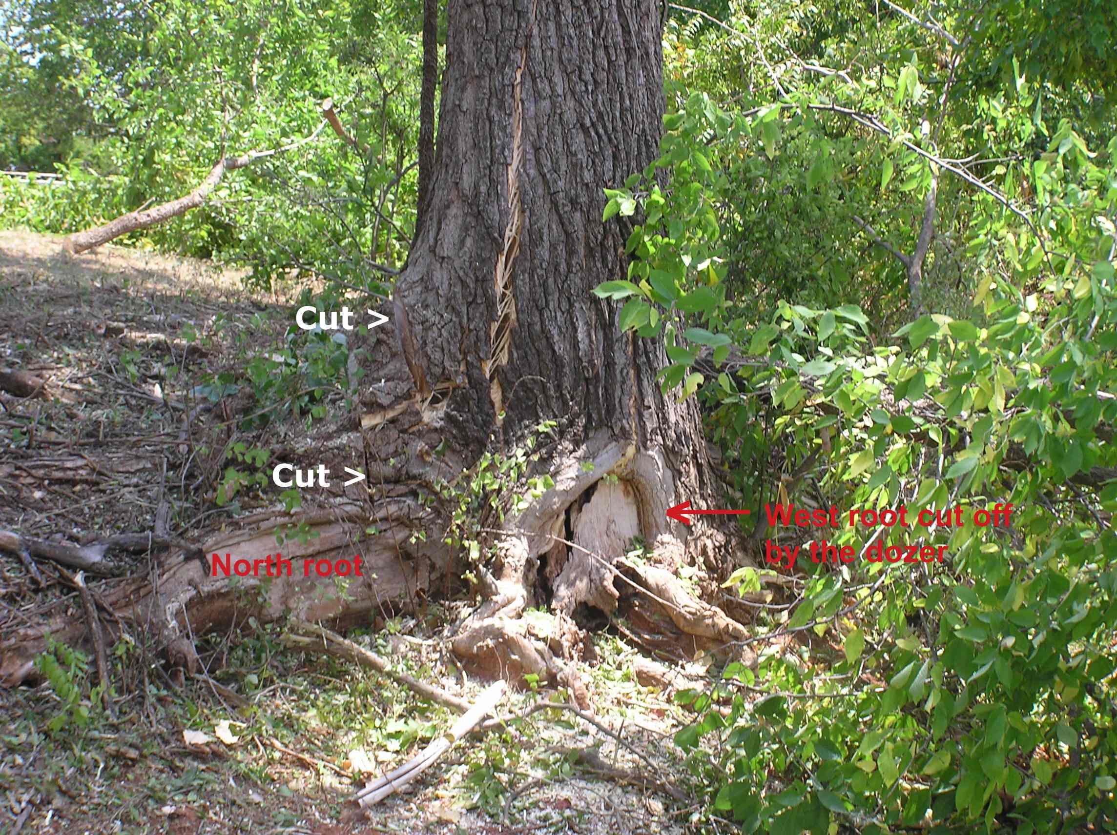

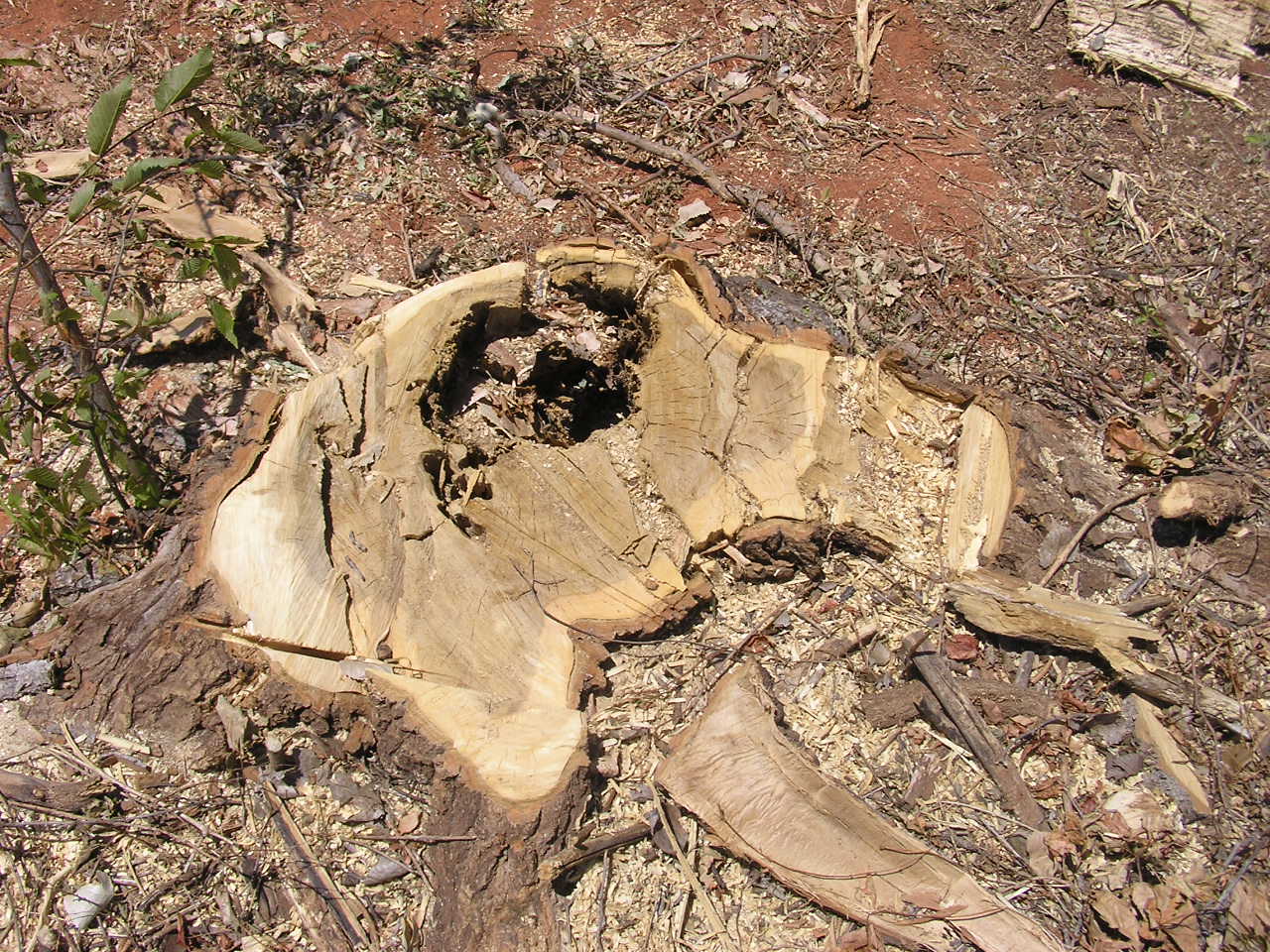

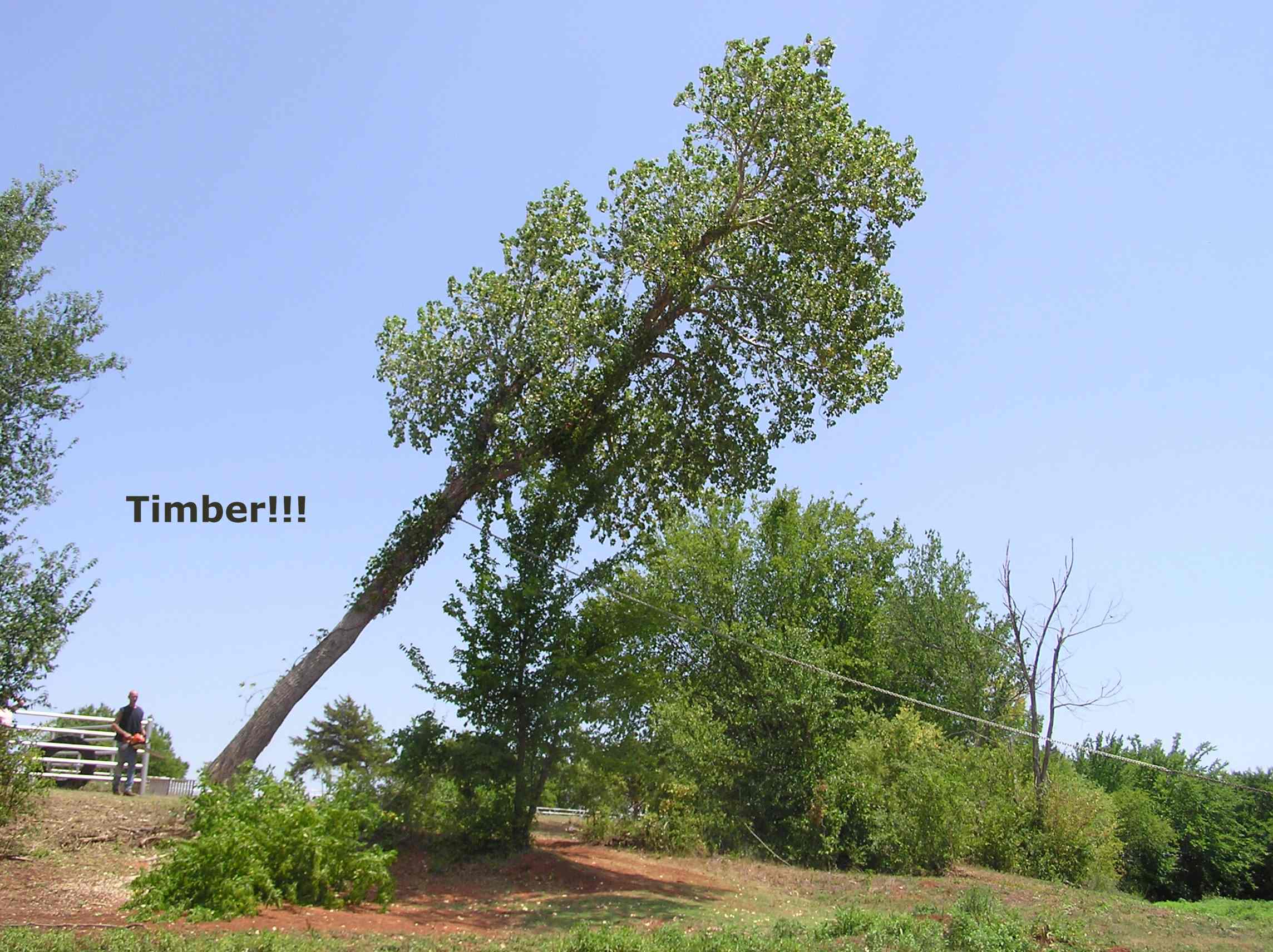

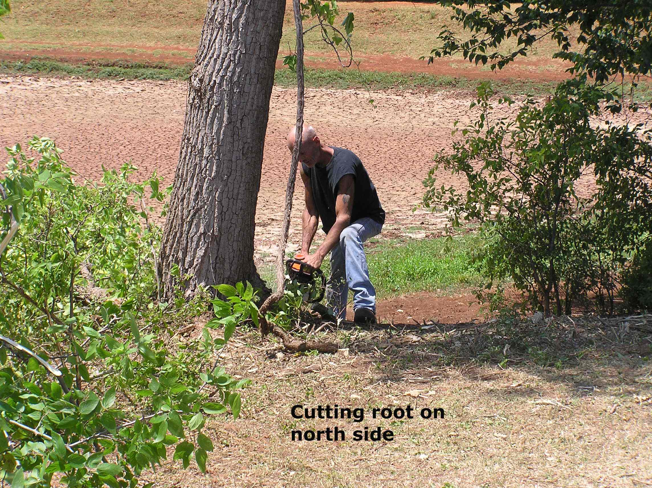

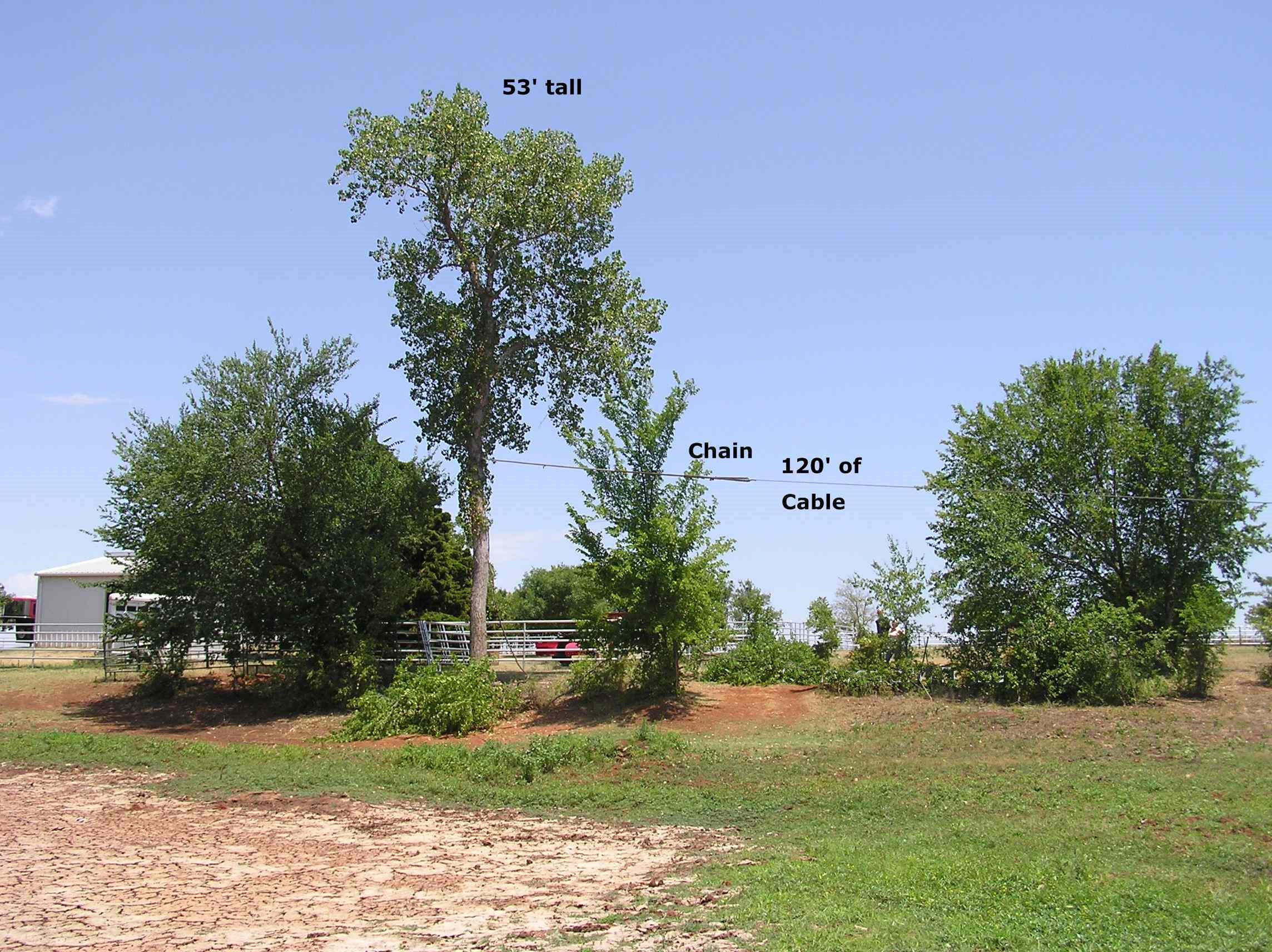

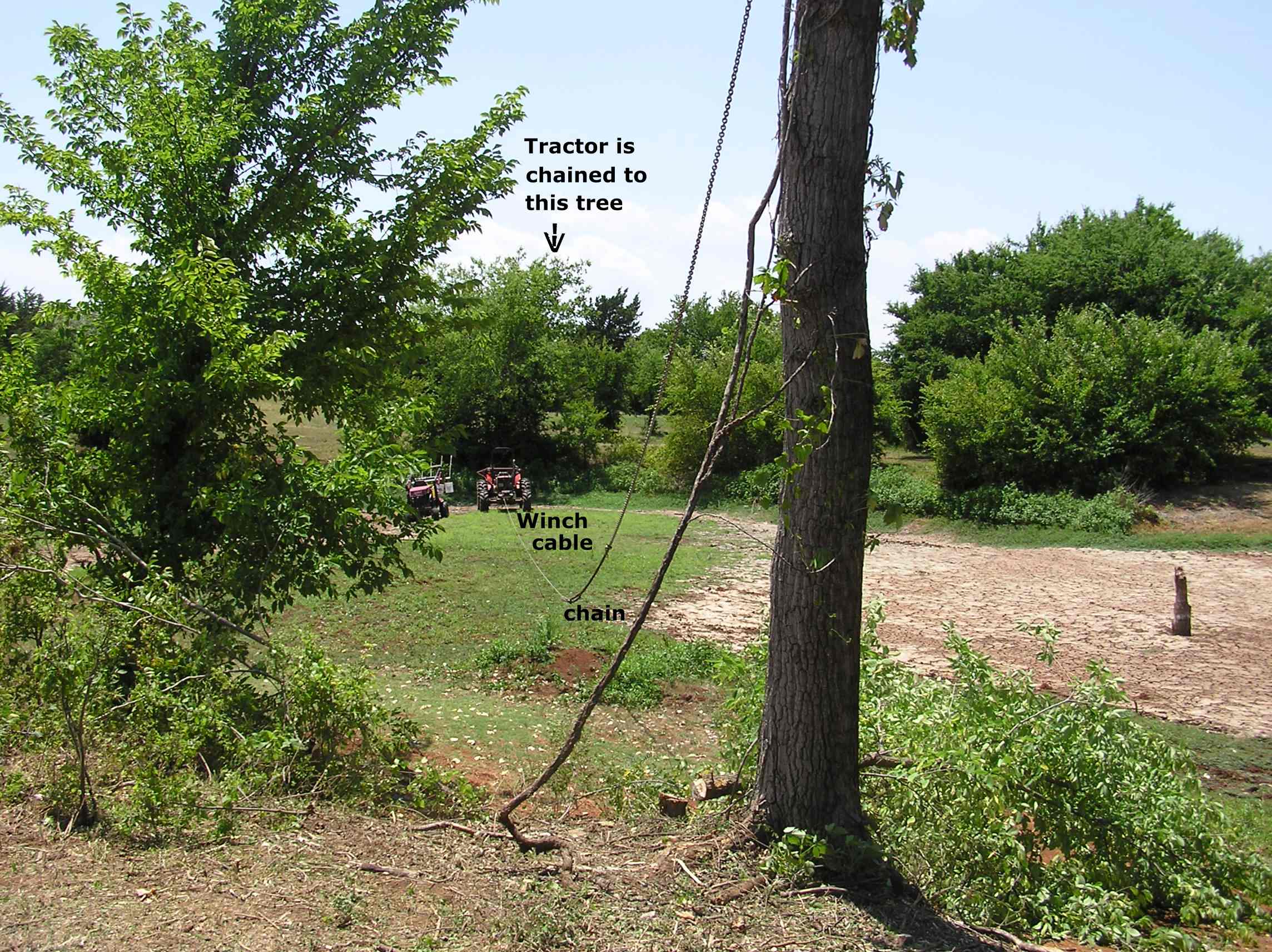

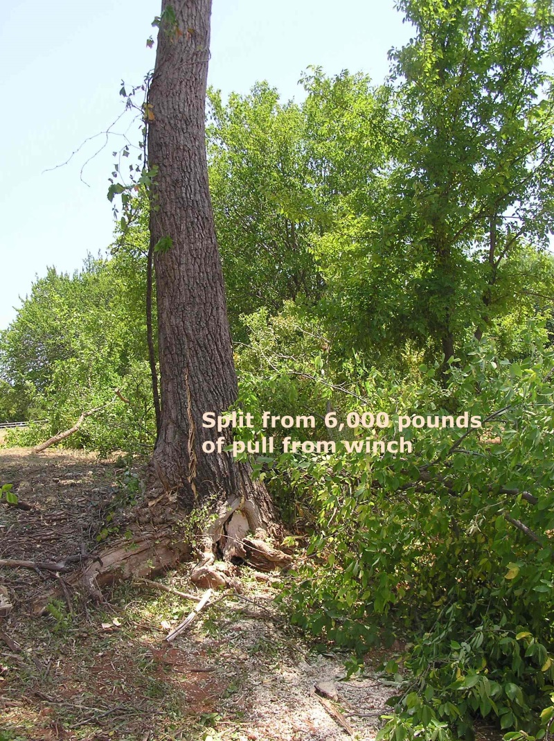

This seems like the ideal situation to use a CHAINSAW :D (oh no, what did I do)
I was wondering if that would get brought up. :)
A chainsaw was used, but not by me. :D
