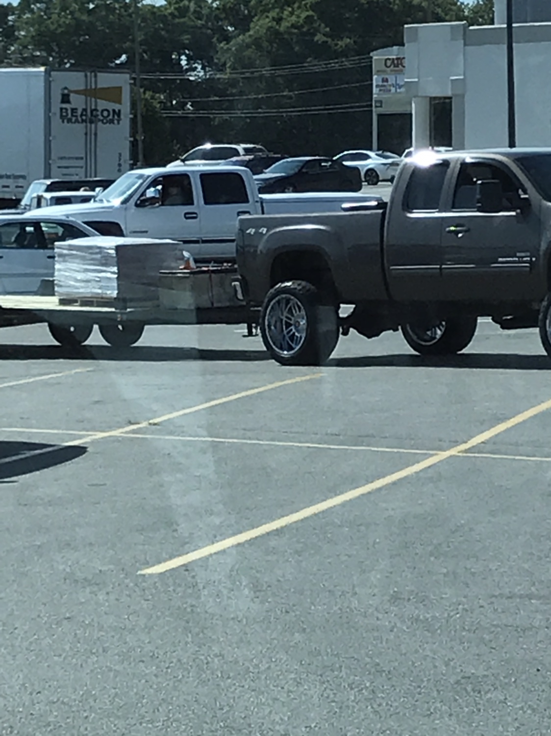

There’s no chance of that happening. To many Americans do this to their “trucks”. IMG_6954.JPG

There痴 no chance of that happening. To many Americans do this to their 鍍rucks? View attachment 613403
That looks pretty low sidewall to me.. should be stabile... just damage prone when going offroad, both rim edge as well as tire.
