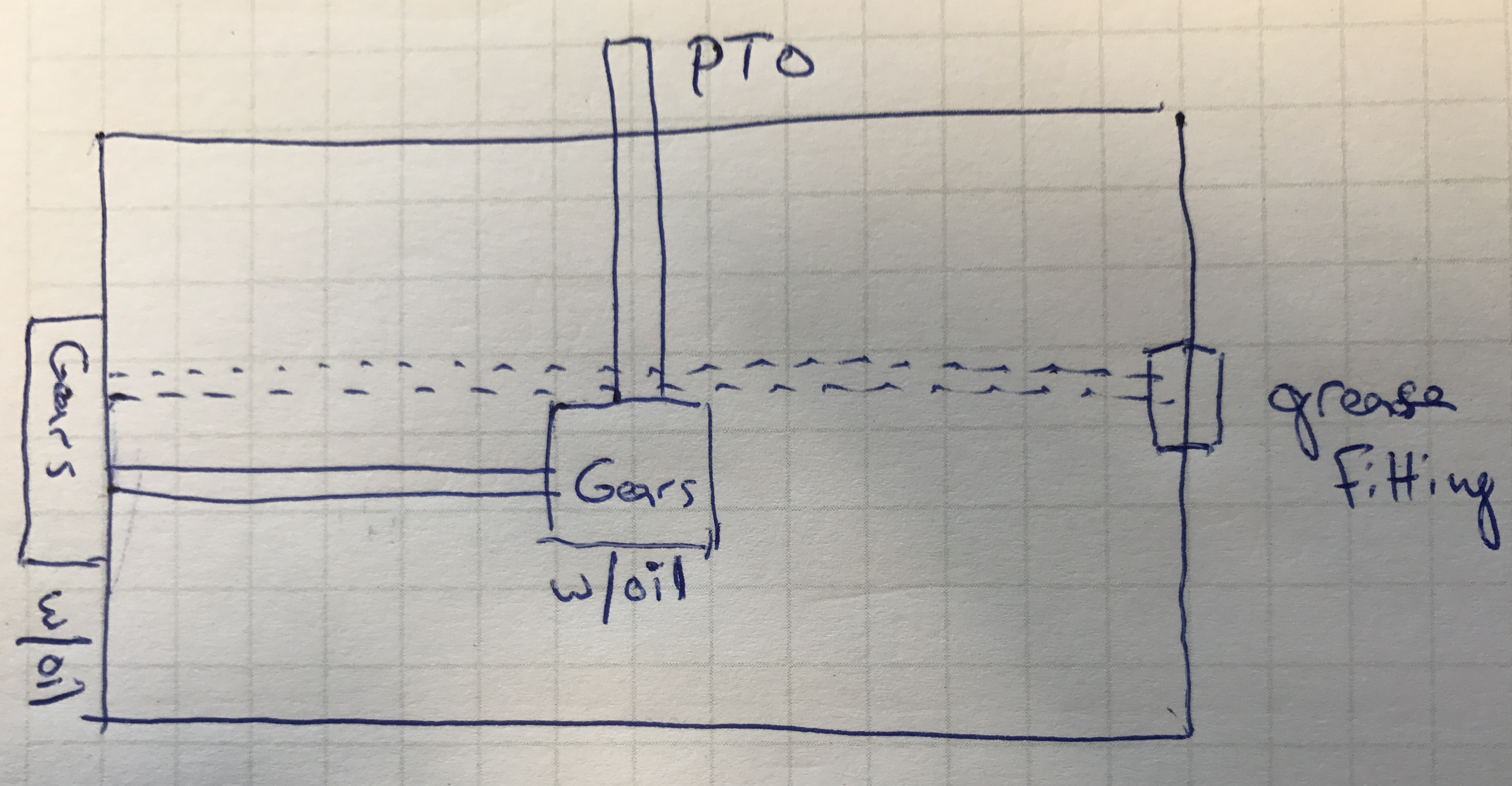

I recently received my tiller from Agrisupply.
Apparently it comes without grease in the outboard bearing and the instructions say to add grease.
I've dealt a bit with bearings and grease, and it's been my general experience that when you have enough in there either A) it starts coming out somewhere or B) you feel pressure in the gun (manual pump). I put about 30 pumps into this thing and see no grease and feel no pressure. It does look like it could be a large bearing housing, but that seems a ridiculous amount of grease for a bearing this small!?? It's just a 4' tiller, not a D10...

Well I'm a little confuzzed. Is the 'outboard' bearing out at the far end (chain-drive) end of the gearbox output (which is the input to the chain-drive) shaft or where?
/ How much grease??
LH end is gear drive. RH end where grease fitting is has no in/out-put, it's just a support. There is no chain involved.
/ How much grease?? #7
Gear drive? Ok. It was a bit fuzzy in the manual I downloaded to look at. Looked like a chaindrive.
RH end is up against the gearbox? So it is the output from that gearbox?
Can you post a picture or three?
/ How much grease??
Not at home right now, but here's a sketch of the layout.

When we opened and cleaned the end of ours and regressed it took an amazing number of pumps before it got tight. We lifted the tiller and rotated it while the other guy pumped the grease. It eventually gets tight and you can't pump, outs didn't have any come out anywhere just got firm.
/ How much grease??
Good to know. Thanks!
/ How much grease?? #11
On my Land Pride the zerk is on the outside and there is a hole on the inside that grease comes out of when it is full. It's about a 1/16" hole so it is nearly impossible to see if it isn't clean and oriented into view. And it takes 2 people to avoid dropping grease on the floor, one to pump and one to look for a greasy little worm. If there isn't a hole on yours or it is plugged, a few pumps is ok or pump until hard, your choice.
