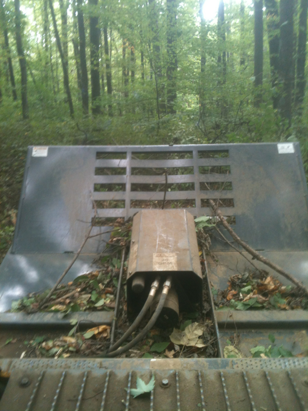

Figured the working hours almost to a tee, underestimated the dead fall that had to be moved but the brush cutting went faster than expected. Over all wish I could book two of them a week.
   / How much ground can a brush cutter cover in an hour? #19
What....no pics of the job:laughing:
#20
LOL!!! And only 4 bee nests, only got stung twice!
