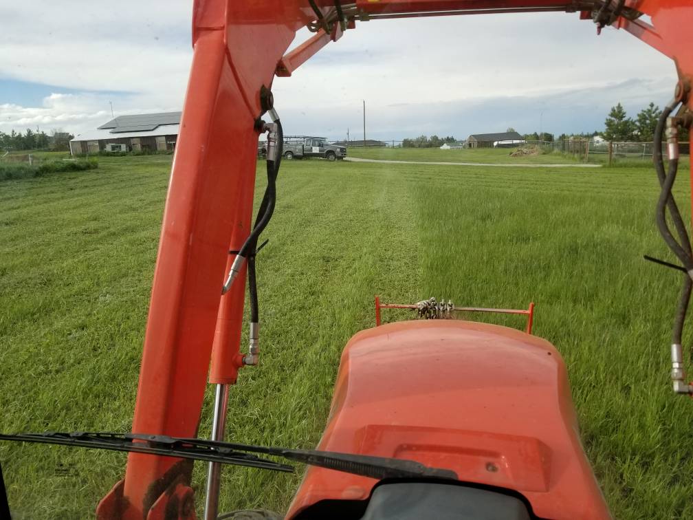

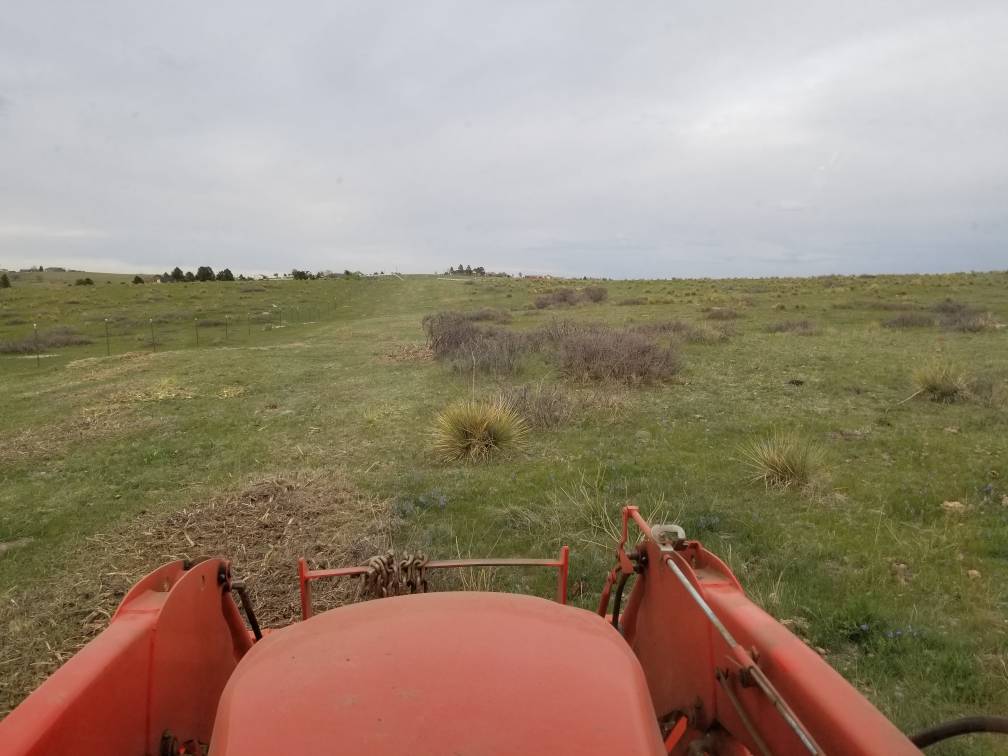

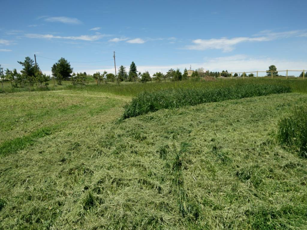

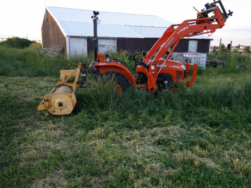

32hp L3200, maybe 25pto. Ran a 7' old junker Ford 917 ok. Thick grass cut WAY harder than brush. I had a 5' rotary cutter at one point. Sold it as the flail did a better job. Better cut, safer, etc. The flail was slower & put a burn on avalible power. But covered acres as fast as the rotary due top the extra width. HST means you press on the go pedal until RPMs fall, then back off a bit. You get max output across varying mowing conditions. IMG_20150614_130140.jpgIMG_20150626_200301-1.jpg

32hp L3200, maybe 25pto. Ran a 7' old junker Ford 917 ok. Thick grass cut WAY harder than brush. I had a 5' rotary cutter at one point. Sold it as the flail did a better job. Better cut, safer, etc. The flail was slower & put a burn on avalible power. But covered acres as fast as the rotary due top the extra width. HST means you press on the go pedal until RPMs fall, then back off a bit. You get max output across varying mowing conditions.View attachment 610094View attachment 610095
Your grass looks like mine but I have some hills too.
How many HP would you ideally have to run that flail mower?
That thick grass was by far the biggest hit on HP & is probably the thickest grass on my property. I was down pretty slow there, maybe 1mph or a bit less. Generally I could do 3, maybe even up to 4mph in light grass with 32hp. I was power limited about half the time, maybe a bit more. The rest of the time I was limited by field smoothness & a not so great back. 40hp would have been pretty good.
Amusingly I now have a 40hp L4060HSTC & have ran that flail on it once, maybe twice. I cant say it was actually memorably different. I now have an 8' Peruzzo flail & it performs about the same. I often cut some pretty rough fields & heavy 1-2" woody brush with it now though. Ideally I'd like 55-60hp, but I'm not disappointed in the tractor or flail. I'm probably going 4mph in the 2 mowing photos at almost full passes down to under 2 for the yucca & heavy brush bits.
Generally it's going to come down to how fast do you need to mow. Slowing down a bit gives a smoother ride anyway.
