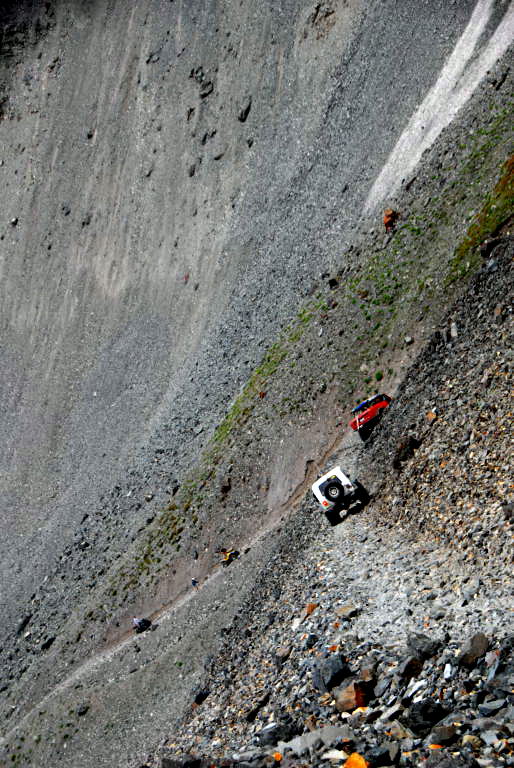

Where to get an "inclinometer?" Would TSC have them? And where do you mount them? Obviously someplace where it can be easily seen.
   / How much incline is too much? #17
They use them most on jeeps for rock climbing. You can search "inclinometer" and go from there. Tractors, of all, are the most dangerous of all off road equipment. Please don't trust your life to a gauge. I will never have an inclinometer because experience is the best teacher. If you are on a slope that scares you enough that you need a gauge then you shouldn't be on this slope at all. You are the best judge of the danger and not a gauge. A tractor will kill you in less than a second. The gauge will register the fact after you are dead.
#18
Good point, Whistlepig, but at least the inclinometer would tell me where I was (degree wise) when I start to get nervous.
