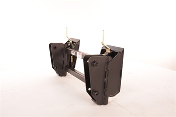

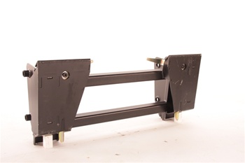

I have a small loader, that I would like to switch over to skid steer quick hitch, how much are they rated for? Loader has about 8k lift capacity. Will I just rip the quick hitch up? Would like to be able to put a bale handler and pallet forks on and still have them for other tractors.

You need to call it quick attach, quick hitch is for the 3 point.
This one looks pretty stout: ATI Tach-All Universal Skid Steer Quick Attach Hitch for tractor loaders
425716-how-much-skid-steer-quick-ati-hitch-tachall-quick-attach
425717-how-much-skid-steer-quick-ati-hitch-tachall-quick-attach
