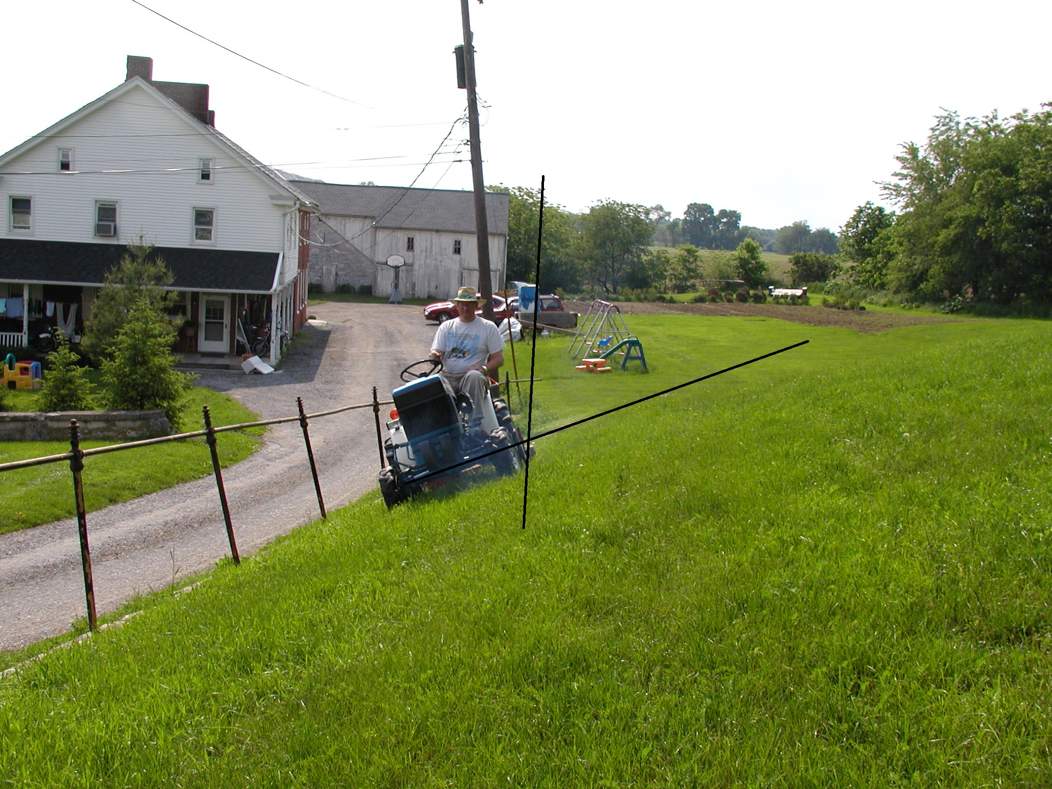

Here's a picture of a part of my MIL's back yard I used to mow. I don't know what the slope is, but it's right at the limit of what the tractor could do. She had about 5 acres of grass. There was no need to have both tractors here, so I kept the Ford in one of her barns and drove the B7500 that I had at the time to her place. With #3 Son on the Kubota on the nicer parts while I used the Ford on rougher terrain it took us about 1-1/2 hours to get it all done.
I drew lines for reference trying to use the neighbor's barn and the front axle for reference. The camera wasn't quite plumb and the utility pole the eye is drawn to certainly isn't. The land behind me drops off into the neighboring yard. The first section I'd mow is the bottom and always in that direction. The remnants of an old fence were sticking up out of a short retaining wall.
1. I always went the same direction, starting at the bottom. The RFM was a side discharge and that got the clippings out of the way better.
2. The tractor always "crabbed" on the steeper part of the slope. This made #1 above important. Mowing in the other direction put the right front wheel in clippings and that affected traction. There were a few times slippage began and the remedy was to cut the wheels uphill and let the deck swing downhill.
3. Even when bone dry, it was always a 4WD section to mow. Don't have to forget that very often to have it burned into memory. It wasn't an area that could be done when the grass was wet.
4. With no FEL or anything to raise the COG, sliding was a reality but there was never any hint of tipping. A contributing factor to that was the 5' RFM always being on the ground. It added some stability.
5. Not that it may have made a big difference, but it always felt a little better to sit with one cheek on the seat and the other on the uphill fender.

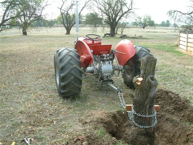

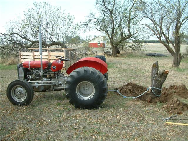

Stay off that slope unless your tractor is set up for low center of gravity and wide wheel track. Otherwise you'll roll that tractor for sure. It's not worth the risk. You can do a lot of damage to your tractor, especially the engine if you can't get it shut down immediately, and to yourself. You'll be surprised how quickly a rollover can happen when mowing slopes, especially if the surface is rough with ruts, potholes, etc.
My 1964 MF135 diesel tractor is set up to squat low for mowing work in orchards. The normal large diameter rear wheels have been replaced by 18.4x16 tires and 16" diameter rims. The front axle spindles were shortened to keep the tractor level. The rear tires are 2/3 filled with water. Something like this would work safely on slopes like you have.
Good luck and be careful out there.
