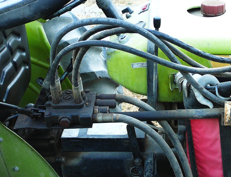

My 30 year old loader on the YM240 does this. Lift will stay up indefinitely but Curl leaks down. I put new piston seals and rod-packings in both curl cylinders, no improvement.
Then lifting something heavy I discovered the control valve dribbled fluid on the ground. Looks like its time to replace the control valve.
Does anyone know of a direct replacement for this valve? Nominal relief pressure is 2000 psi and 4gpm hydraulic pump. The name cast into the valve is 'AICO'.
Baileys seems to have some bargain valves lately. Check this one out:
Directional Control Valves 220-907 Detailed Information
If you want a float detent for the lift function: http://baileynet.com/index.php?dnfwd=1&page=ProductDetails&line=CVED&baileyno=220-956
Edit: Joystick option: http://baileynet.com/index.php?dnfwd=1&page=ProductDetails&line=CVED&baileyno=220-957
Surplus Center: http://www.surpluscenter.com/item.asp?item=9-7862&catname=hydraulic
Get the power beyond plug and add a hose from the return port to the tank to do it right.
While you're at it a couple of your hoses look ripe for replacement.
Edit: Bottom line, valves are pretty generic. You don't need an identical valve, just one with specs that match the function. Do pay attention to the port sizes. You may need adapters. I like the off-the-shelf hoses with npt fittings with adapters going to the valves as needed.
