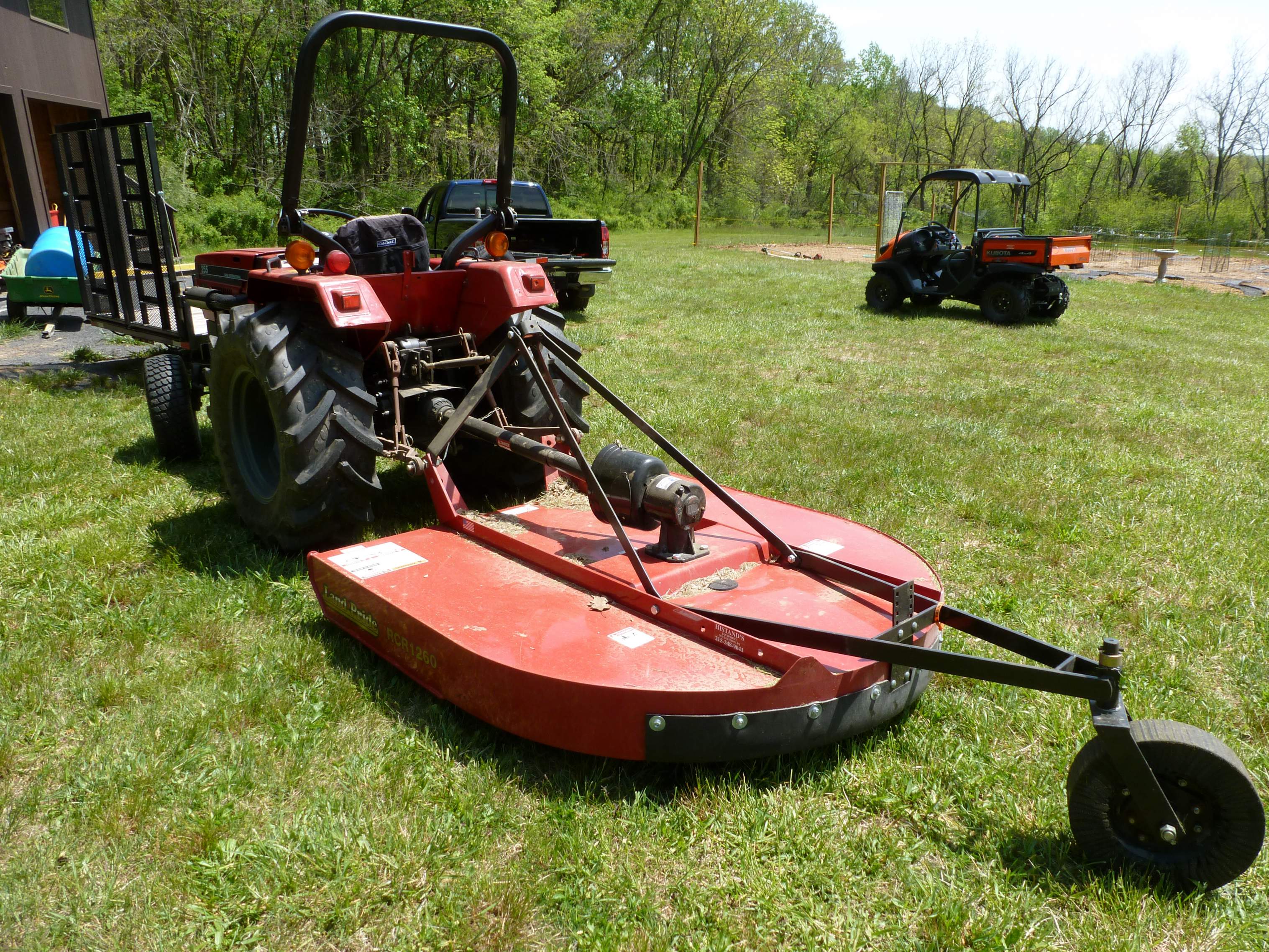

I thought you might find this pic interesting to confirm comments on front weights. When I first got this mower, which is as big as the tractor, it was Land Pride's lightest weight 60", intentionally, since I was mowing field grass, never brush.
When I raised the mower up, and stepped on the rear of the mower deck, the front wheels of the tractor lifted up. That sure got my attention. 300 pounds of front weights later, all was well.
