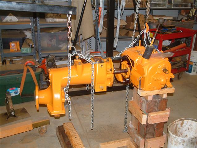

Roundish gear boxes? Are you referring to the bull gears that are used on the rear axles of some high crop tractors--like the 1951 Minneapolis Moline BF tractor that I'm restoring now?
View attachment 227452View attachment 227453View attachment 227454
If so, the answer is no--my 135 is a standard field tractor without bull gears like a high crop. No modifications were made to the rear axle. The original owner replaced the 28" dia rims that you generally find on the rears of field tractors with 16" dia rims carrying Goodrich 6-ply 18.4-16A rubber. He used shortened spindles on the front axle to keep the tractor level. He used it mainly for mowing and discing his olive orchard, essentially converting a field tractor into a low-squat, high-floatation orchard tractor. BTW--this is a simple way to modify a field tractor for mowing steep slopes. The 18" wide rears are used on a variety of big ag equipment (swathers, combines, etc) and are readily available at places that sell ag tires, like Les Schwab out here on the West Coast.

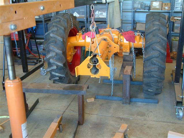

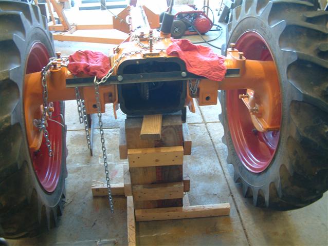

Brake replacement hassle? Yes and no. It's not that bad. Here are the brakes on that MM BF tractor (the yellow and red one). They're under the red shop towels in the photos. You can do a complete brake job without removing the rear wheels. During the restoration, I did the brakes on the workbench after I removed the rear axles--easier that way.

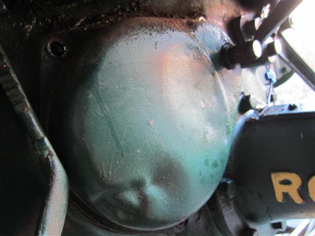

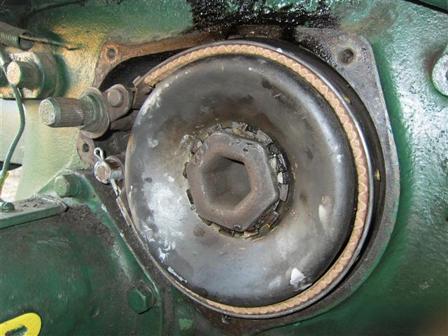

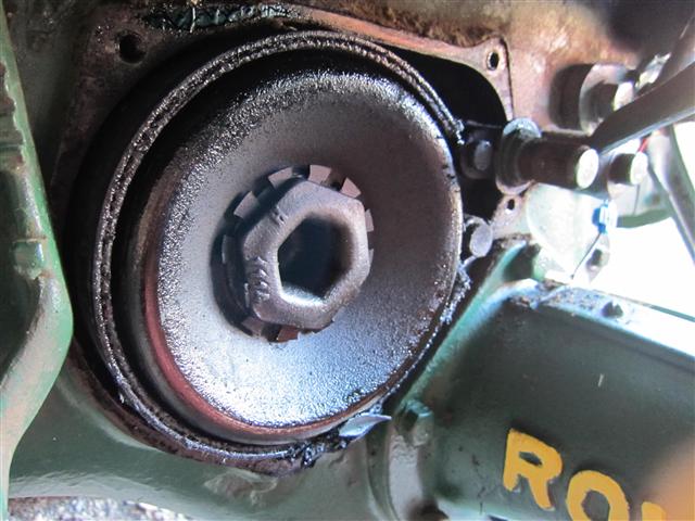

My 1945 Oliver 60 Row Crop has a different arrangement but the brakes can still be replaced without removing the rear wheels. The brakes are attached to the shaft in the differential that carries the small gears that drive the bull gears on the rear axles. You just remove those round covers ahead of the rear axles and you can do the brake job sitting on your butt.
DSCF0052 (Small).JPGIMG_0434 (Small).JPGIMG_0435 (Small).JPGIMG_0626 (Small).JPG

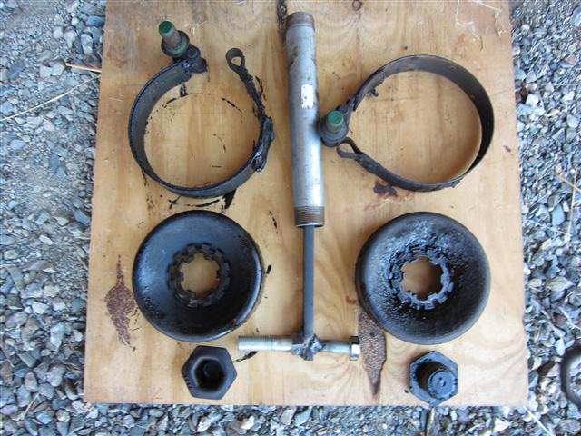

I bought that Ollie last Jan, it runs fine, has a parade ready paint job and only cost $2250. However, the right brake lining was completely gone and the left lining was soaked with gear oil. Had to replace the two shaft seals behind the drums and reline the brake bands. The right drum was pretty scored so I went hunting for a replacement. No luck from the usual suppliers but I found one on eBay for $20 plus shipping that turned out to be OK. The drums don't have to be perfect because Ollie has been retired to parade duty.
Another challenge in restoring old tractors is tools--most tractors requires a few unique tools that normally a dealer would have. If the manufacturer/dealer network is out of existence like MM and Oliver, you have to rely on eBay, craigslist, etc. or make the tool yourself. In the case of the Oliver 60's brakes, there's a tool to remove that big hex nut that holds the drum to the axle. Luckily, the head of a 3/4" hex bolt fits the socket in that nut nearly perfectly, so fired up the welder and made a tool. It's in the center of this photo. Put the transmission in low, chock the rear wheels, use the pipe cheater, some muscle and, presto, those two nuts are loose.
