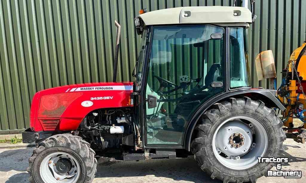

I think I found the ideal slope tractor, but it's out of production and only available in Europe.
Massey Ferguson 3435 has a very low center of mass for an 80 HP tractor.
