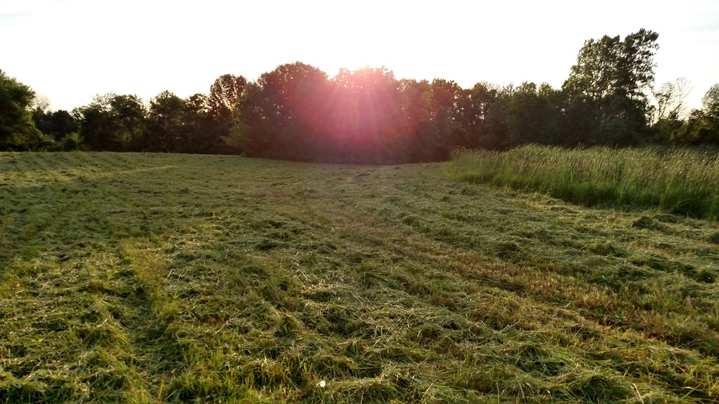

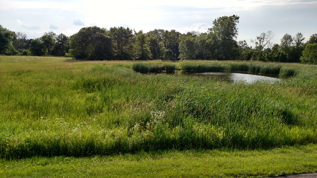

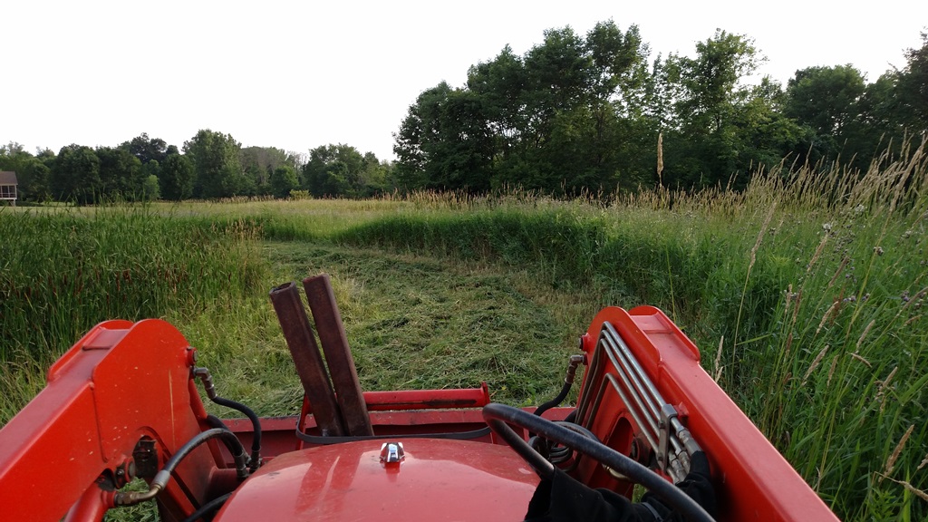

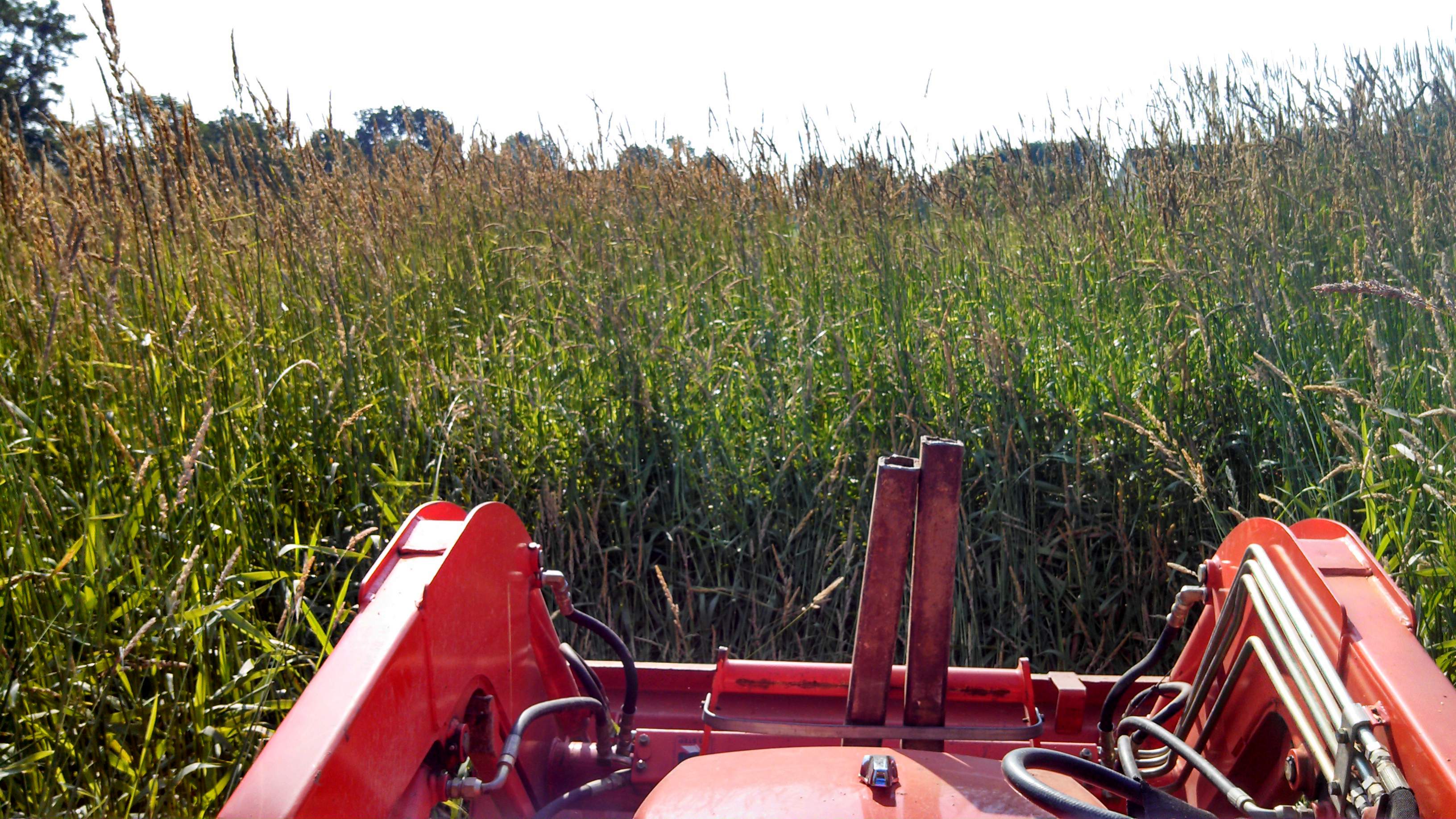

Are you typically doing larger jobs? 10+ acres? And how do you factor in your travel time?
Job I just did 2 nights ago was 3.2 acres. Located 35 miles (45 minutes away). Took 1.5 hours from the time I pulled in til the time I rolled out.
IMG_20130622_092036_992.jpgIMG_20150622_183224118_HDR.jpgIMG_20150622_192402718.jpgIMG_20150622_200023221_HDR.jpg
IF I charged $25/acre That would have been $80. No way to make money on that. I charge $200 for that job, and have done it twice a year for the last 3 years. So thats over $60/acre
Now I have done some 10-15 acre jobs in the past that werent too overgrown (get cut a few times a year) and closer to home That I get down close to $30/acre. But I think my average job size is around 3 acres. And my minimum for loading equipment is $175. Which the minimum covers most 3 acre and smaller jobs that are a reasonable driving distance away
