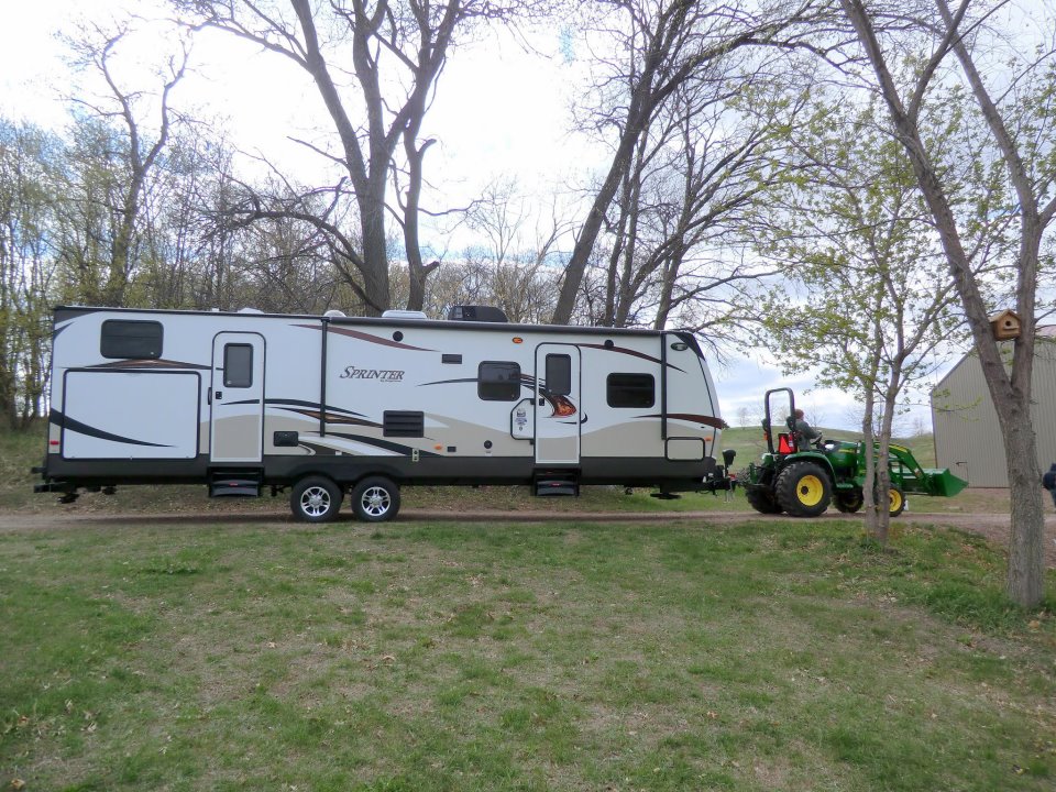

   / How much tractor needed to move 25" Travel Trailer? #15
I use my 3320 to move my 35' - 8,000 lb TractorTow.jpgcamper around and get it into and out of my shed. The door is 12 x 12 and the trailer is 8 x 11.5, so it takes the maneuverability of the tractor to get it in. Also doesn't help that the driveway is only 35' from the door, so a sharp 90 degree turn to get it in. The driveway is gravel, so it turns pretty easy. I have my son help with backing it in since I can't see around it :).
   / How much tractor needed to move 25" Travel Trailer? #16
Holy crap. Tractor looks tiny.
   / How much tractor needed to move 25" Travel Trailer? #17
Trailer looks like it needs it's own zip code.
Nice rig, for when you are "roughing" it ! :thumbsup:

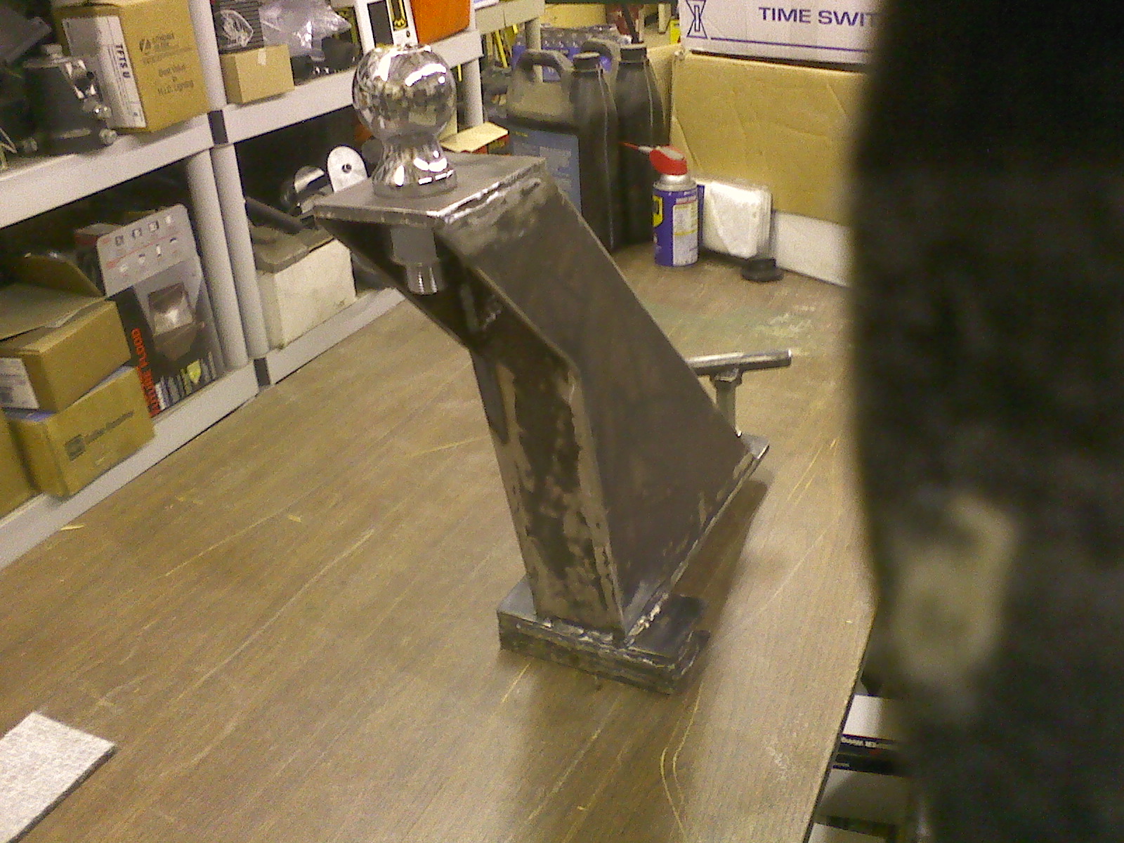

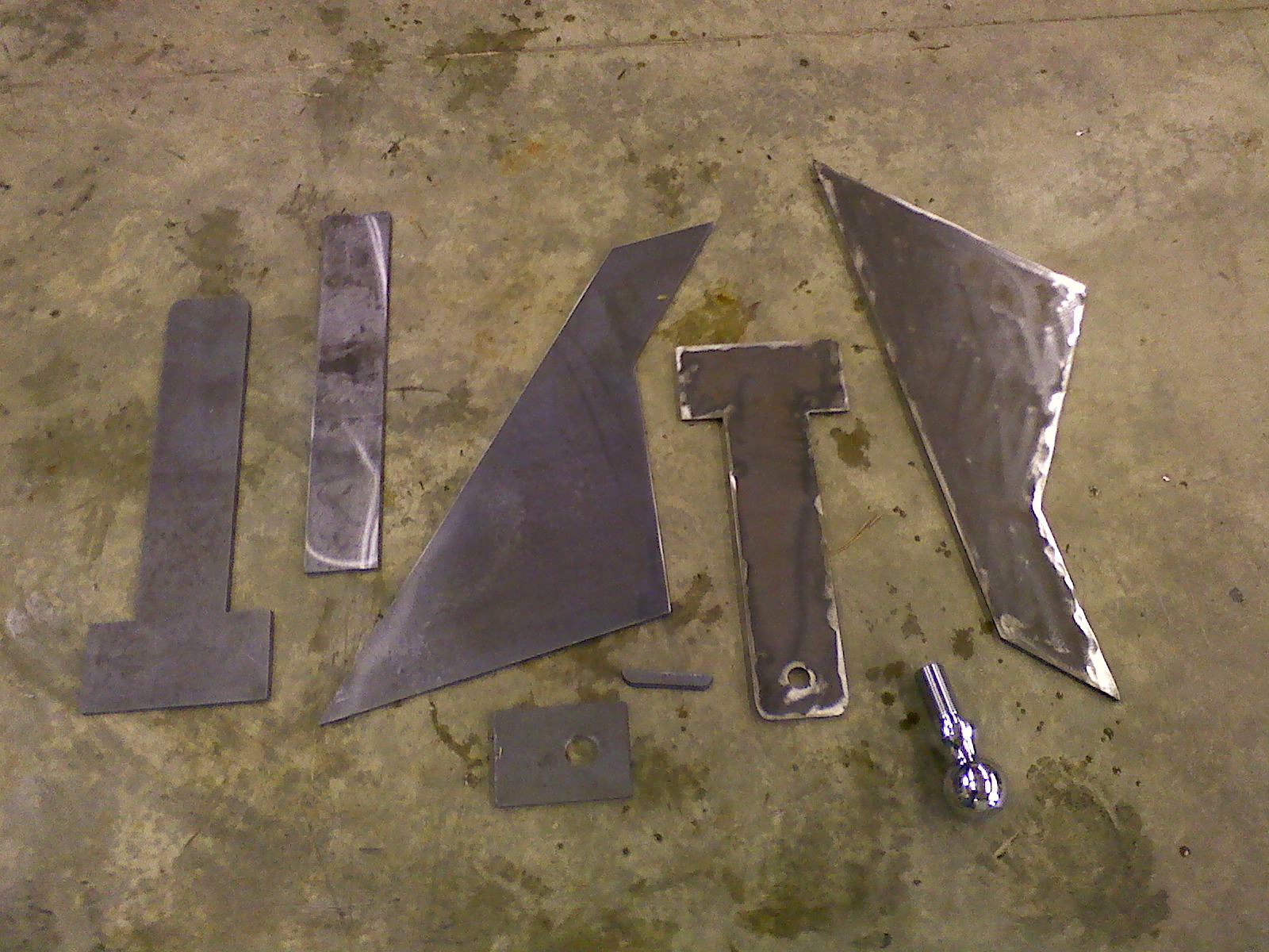

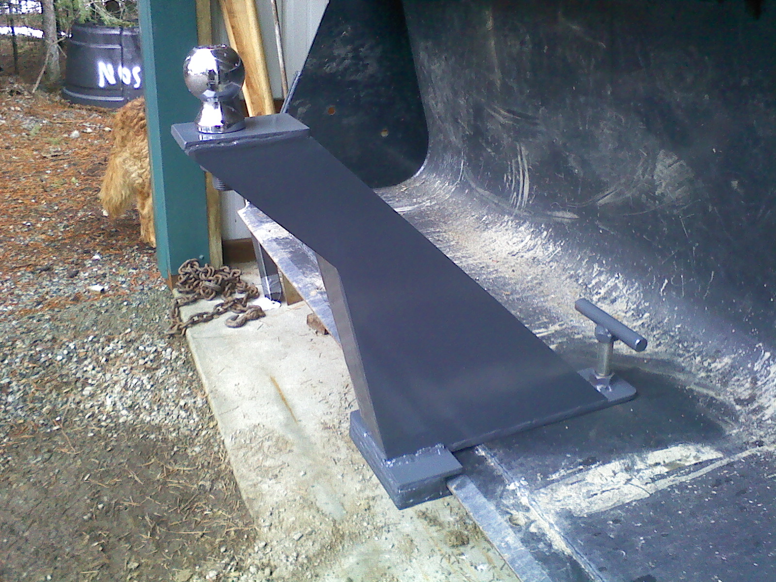

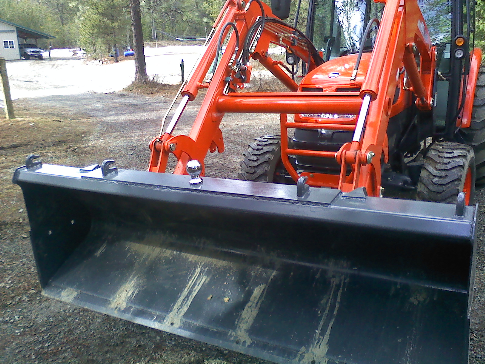

I have made 2 different kinds of attachment points for my trailers. The first is a 2-5/16" ball permanently attached to a re-enforced bucket. I added an upper and lover 3/8" plate to the bucket. so there's nearly a0327111953.jpg0327111535.jpg0327111954.jpg0329111630.jpg0327111410.jpg 1" thick attachment point. I move my 30' gooseneck horse trailer with this.
I also made a clip on bracket for the loader bucket with a 2" ball for moving the dovetail trailers. I had to make mine rise some so i can see attachment point without hitting my head on the roof of my cab. both work flawlessly. The removable one clips on and off in about 10 seconds.
