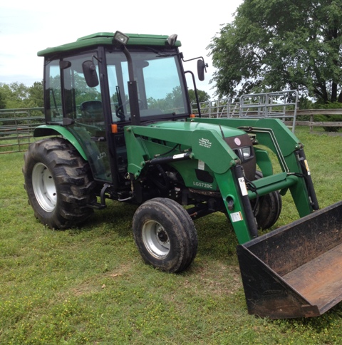

I just recently bought this used 5720C with 133 hrs on it ... nice clean tractor and a good deal... been using it around the farm and it appears to be a great little 57hp machine.
Yesterday I took the first road trip, stereo on, a/c going and I thought to myself what the heck is that high pitched whine? I open the back window and it was really loud ... I thought holy cow there must be a bearing going out.
Pulled over and touched everything I could think of and could not find anything even the slightest bit warm ... continued to my destination and worked about 4 hrs and headed home ... only makes the 'whine" in road gear under load ... in other words down hill nope, up hill yep.
Now I know some tractors whine in road gear but this puppy really is good at it. I changed all he fluids when I first bought it and everything appears to be topped off ... Just curious if some of yours whine?
