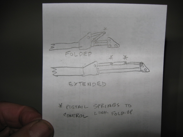

A folding brace is an interesting idea but it would be stronger as a triangular design.
The rectangular brace will keep the end vertical as the bar bends but won't do much to stop the bending.

Ok, now I'm picturing a boom that installs (vs telescopes) into the 'hitch receiver' plate for my SSQA. (lifting leverage at the rt end would be less that far from the pins) btw: The triangulation was fundamental to my initial vision and faded away as I drew anew. :mur:

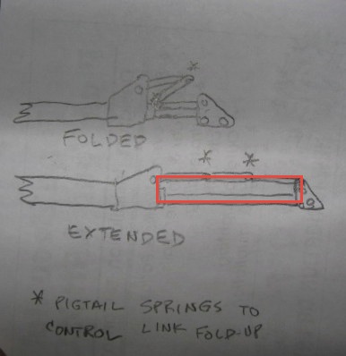

What you are doing with that upper tension link could reduce the rotation at the end after all the slop from all the joints are spent and the links are tight. But it won't reduce the bending much. You might as well use a chain or cable for that.

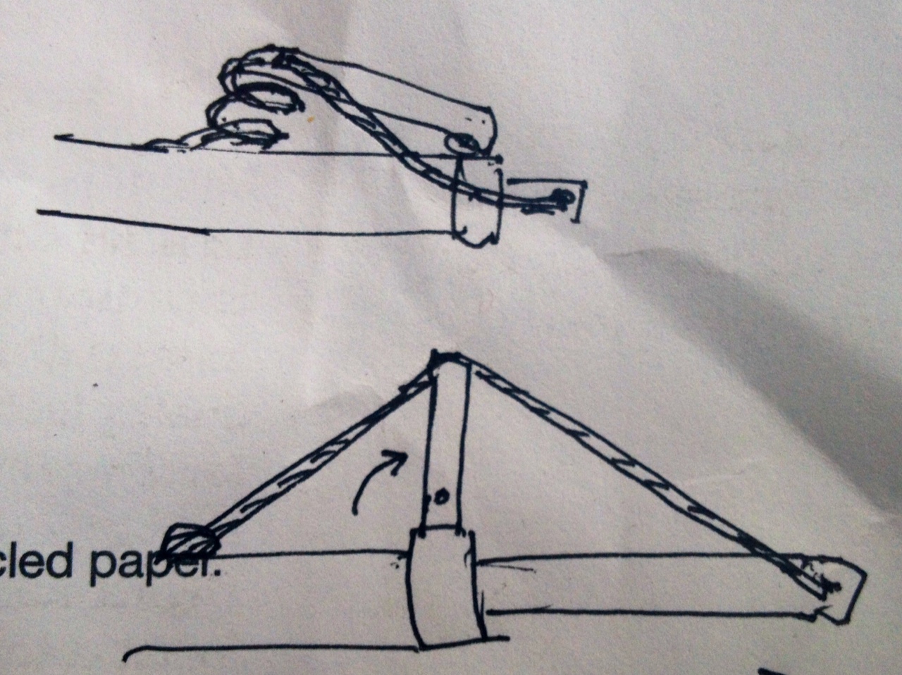

You need some triangles - those parallelograms won't help you. Just trying to repeat a little different what Bruce (above) said.
Here is an example of a design with triangles. You have to be sure that the 'boom' cannot slide back into its housing, it really has to be pinned there to pick up the strength of the cable truss, in other words if that cable can slack; the boom will bend.

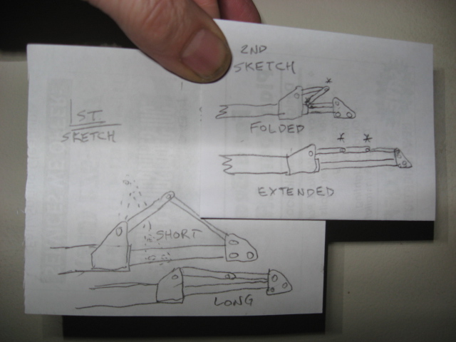

Heh.. Sodo, not meant to be 'paralellograms' ever. Your sketches are more clear, less confusing, show angles better for sure. (thanks!) Guess I could've used bigger paper, or drawn one sketch/page. ('long/short' was squeezed onto my grocery list ... covered 'milk, bread' with 2nd pic) :laughing:
Chain would work, allow adjustment. Didn't count on room to anchor either type behind the overlap of inner/outer booms, or above, so my (short) plate there. (No longer assuming they'd telescope ..) Might've shown a 30/60^ triangle config if OP had said there was room above that point to anchor to something there. (doh! .. tho' I did start off with "do you have room..?")
Sodo's sketch/layout looks good, doesn't it? Sub my (intended) fixed upper chain anchor point for his vertical link if needed. (high compression load there if as shown) Just un-pin 'boom' and chain/link from its end when dismounting. Enough of this folly, I say! We don't know if the OP can use any of this s__. (I'm sure he'll check in when he stops laughing .....)
