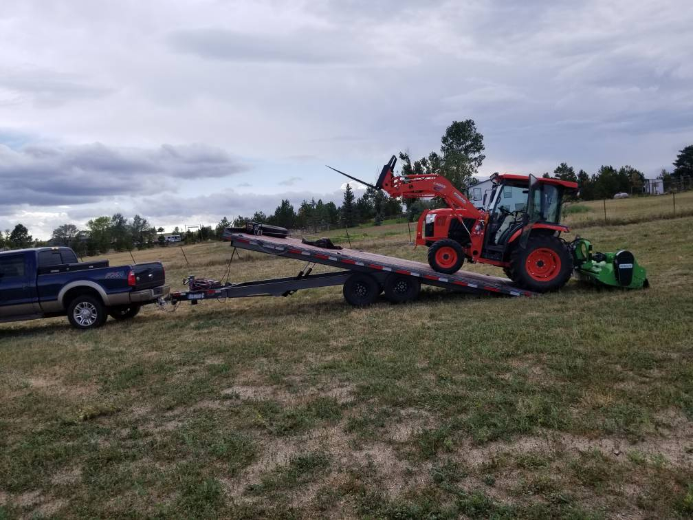

This is as far as my Harbor Freight 12k winch could pull my L4060. As it sits with the loader & flail, probably 7k lbs or so. Tractor ran fine other than leaving it in gear with the brakes locked. I was testing out the 2" reciever welded on the front of the trailer to see if everything would hold. Welds, front brace & cheap Amazon winch cradle all held up.
It would pull things fine if it could roll at all. If the drive train was locked up I'd have to double line it.
Only used the winch 3 times in the few years I've had it. Loading some logs & 2 dead but rolling vehicles. Nice to have just in case though.
   / How much winch is enough? #25
I have a trailer very similar to the one in post #24. I used a 2 ton come-a-long to load a 1993 Cadillac STS and had to resort to using a snatch block to double the power in order to get it loaded.

Good to know. Nice picture.
