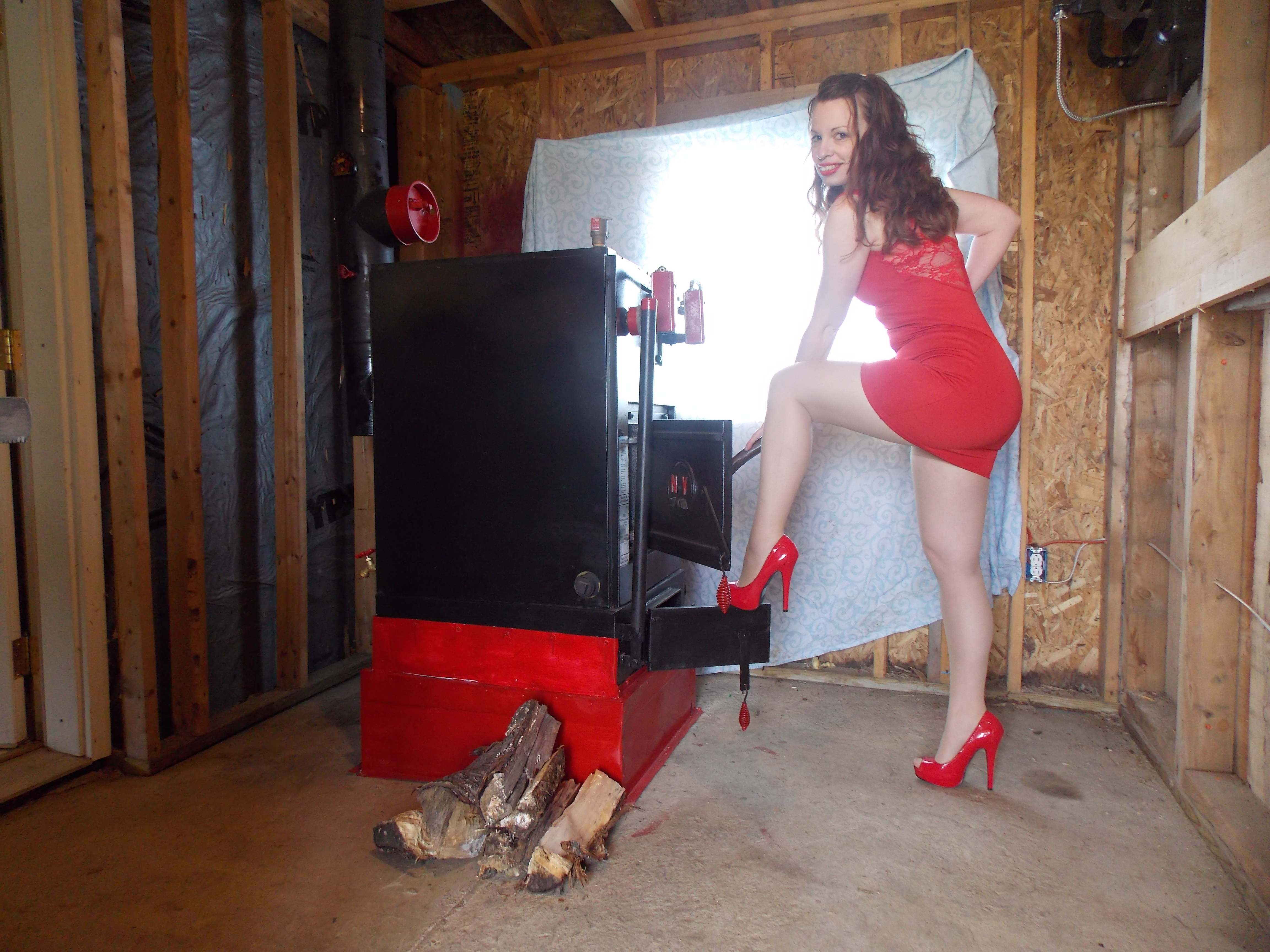

The boiler was in sad looking shape when I bought it, but one thing I have learned over the years is to look beyond rust and dirt. If a person cannot do that, it REALLY costs them a lot of money. With this boiler I first tested that water jacket, pumping 10 psi of air into it and leaving it bloated for over a week. I was satisfied with that, so I went and started cleaning it up, and painting it. It is in really nice shape now.
Some guys on another forum helped me to hook it up and asked if I would take a picture of it, one with my wife and the boiler together so 'they could determine which was better looking". It even surprised me that she donned her little red dress and posed before it knowing the photos would be on the internet. She surprises me sometimes...

Imagine if she wore a black dress with red shoes! You wouldn't be able to tell the difference between the two. (I gotta get out more).
