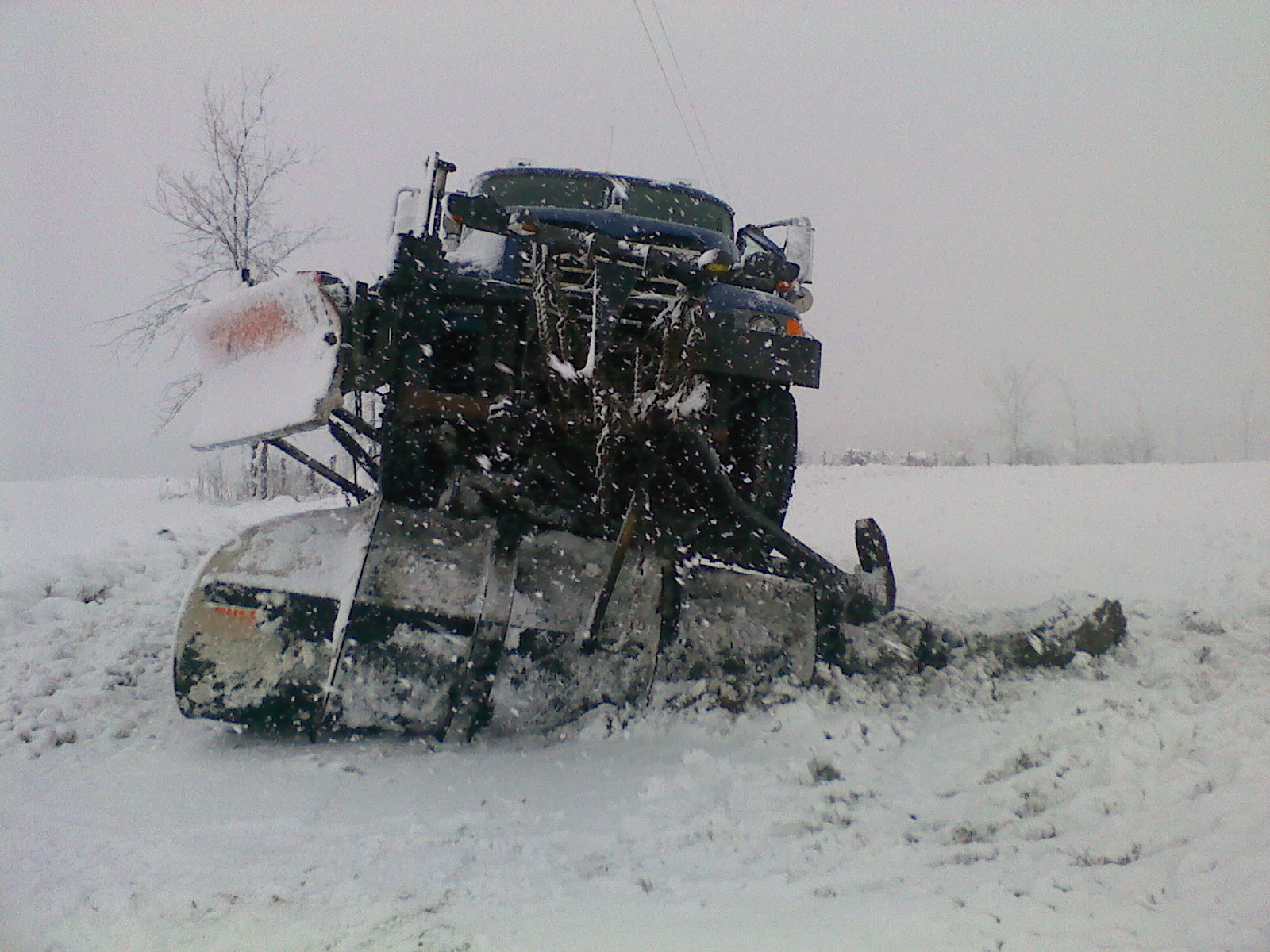

how to drive over your plow

Hopefully a few fillings in teeth didn't need reattaching.....Ouch...:(

One of our drivers did that a few years back, and a nearby township did it last year. It is not caused by the plow buckling, what happens is a good hard shock knocks the plow off the truck [stab lock or drop pin hitch], then the truck crashes into the plow and literaly runs it over. Seen it a couple times, ugly stuff....... but it can happen to the best of us.
