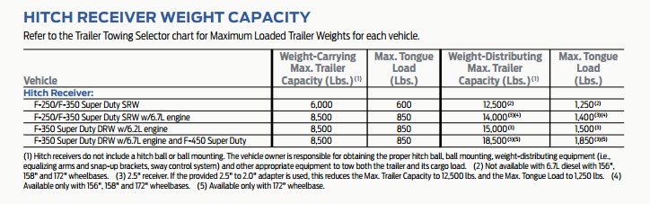

lol. the bumper on a v6 dodge Dakota (just the bumper with no hitch) is rated for 500 pounds. I don't know what truck you own but dodge and ford hd non-dually trucks can handle 2000 pounds on the hitch. that's just the rating and they can handle twice that amount. ****, I had an old buddy with a junker chevy s10 4 banger that hauled a long wheelbase single axle landscape trailer with more than 500 pounds on the tongue plus another couple hundred pounds in the bed. what 1/2 and 3/4 trucks are you buying????

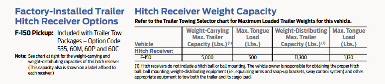

2013 Ford F150 - Factory hitch rated for 500 lbs without a WD system.
http://www.ford.com/resources/ford/general/pdf/towingguides/13flrv&tt_f150.pdf

2013 Ford Super Duty pickups - Factory hitch rated for between 600 and 850 lbs depending on spec.
http://www.ford.com/resources/ford/general/pdf/towingguides/13flrv&tt_superdtypu.pdf

That's pretty good, but what they don't tell you is that those numbers both assume a WD system, which I know because I own a Dodge Ram pickup, and I went through this rigamarole some time ago. The actual rating of the receiver hitch without a WD system is significantly less. On my 2005 Ram 2500, rated for 1200 lbs tongue weight with WD system, you can only have 350 lbs tongue weight without the WD system. Presumably the Dakota's rating is similarly reduced by the lack of a WD system. If you're skeptical, and want to take the 1200 lb rating as "without a WD system," ask yourself whether you think a 2009 Dakota had almost double the rated tongue weight of a 2013 Ford F-250/350/450. Probably not.

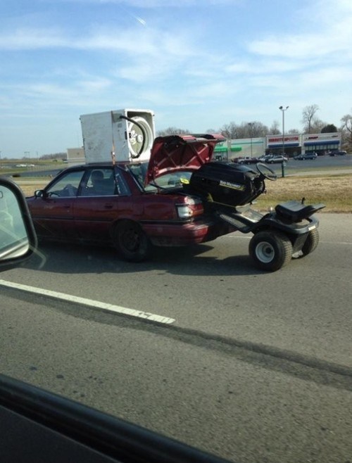

Please tell me YOU took that picture!
Nope not me at all! I found this pictures somewhere on the web a long time ago. I downloaded it because I thought it was hilarious! I guess I'm a picture thief!!:dance1:
   / How (not) to transport a tractor #16
Dang, I had hoped it was you! I would have wrecked taking pictures.

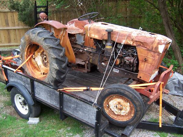

   / How (not) to transport a tractor #17
I am guessing it was transported a lot, since the front of the trailer was modified for extra length and the front tires to fit on the tongue.
   / How (not) to transport a tractor #18
Yup! That would have been one of those wet my pants type of moment!!
   / How (not) to transport a tractor #19
At least the tractor is not the trailer!!:eek:
I have had those little MTD transaxles apart several times. They dont have bearings, they have bronze bushings, and they don't have 80/90 weight oil in them either, they have bentonite grease. I cannot even imagine trying to pull one of those at anywhere near highway speeds without the transaxle burning up. Not to mention the lunacy of what they are doing overall.
That's a good observation, maybe the trailer is used to haul those sized tractors for whatever reason. That particular tractor doesn't look like it's done much work in a while, but who knows?
