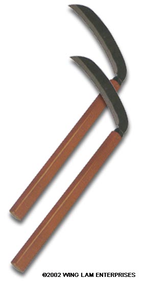

Just a steel tool that looks something like the martial arts blade with a handle, called Kama's. Stick the pointed blade in sideways, rotate up and tilt the handle to the side. I haven't had any roots like you have, but it works on grape vines and long weeds, etc. You might also consider a set of pruners for roots that size. Sawzall should work. I think I would bring that mess on your tiller back to a hose and wash as much dirt off before any attempt at cutting roots.
I used to clean the vines off with a pocket knife. Took forever.

I tried tilling where I had just bladed off massive blackberry bushes, and got roots jamming the tiller like in that photo. A curved pruning saw helped to cut them out. If I had a drywall saw with a sharp point, that would be easier to jam in next to the axle. A cordless sawzall sounds like a better idea.
HF had curved linoleum knives on sale recently. I got one to weld to a piece of conduit, to reach in from the side and cut roots out of the tiller. Also, the local hardware store has grape-harvest knives that look like a linoleum knife but including fine teeth. I'll try one of those if the plain knife won't do the job.
