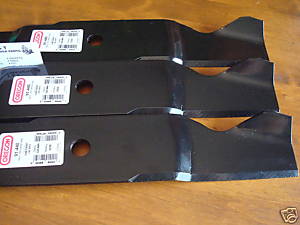

The first ones were the original blades. The second set I bought at the IH/Case/Cub dealer for $75. The set I have now I bought from a Cub supplier on eBay and are still OK. These are the high-lift blades recommended for the triple bagger and have a 1" by 2" almost vertical ear on each end. They start wearing by forming a "V" where the bend starts on the ear (I think on the outer end) until it eventually cracks completely off.

I use the high lift blades and get them at the dealer and our lift fins crack and brake off too.
You need the fins to throw the grass. We've started replacing JUST the inboard most blade so the grass throws out in an acceptable manner. The last 2 blades closest to the discharge can have a fin broken and the deck will still function well.
I sharpen as shape as I can not razor sharp but sharp like a working survival knife...even sharpen new blades out of the box...there blunted for handling/ shipping I guess.
Blades use to last us a few years, not anymore.

I sure would like to see a picture of these blades that the ears break off. My blades are the same width the entire length of the blade. They are high lift. They are robust enough that Carl would probably use them in the movie. : laughing: "whatcha gonna do with that blade?" "I'm gonna kill you with it" -Carl Slingblade

Here is a picture of the high lift blades used in the 54 inch deck.
