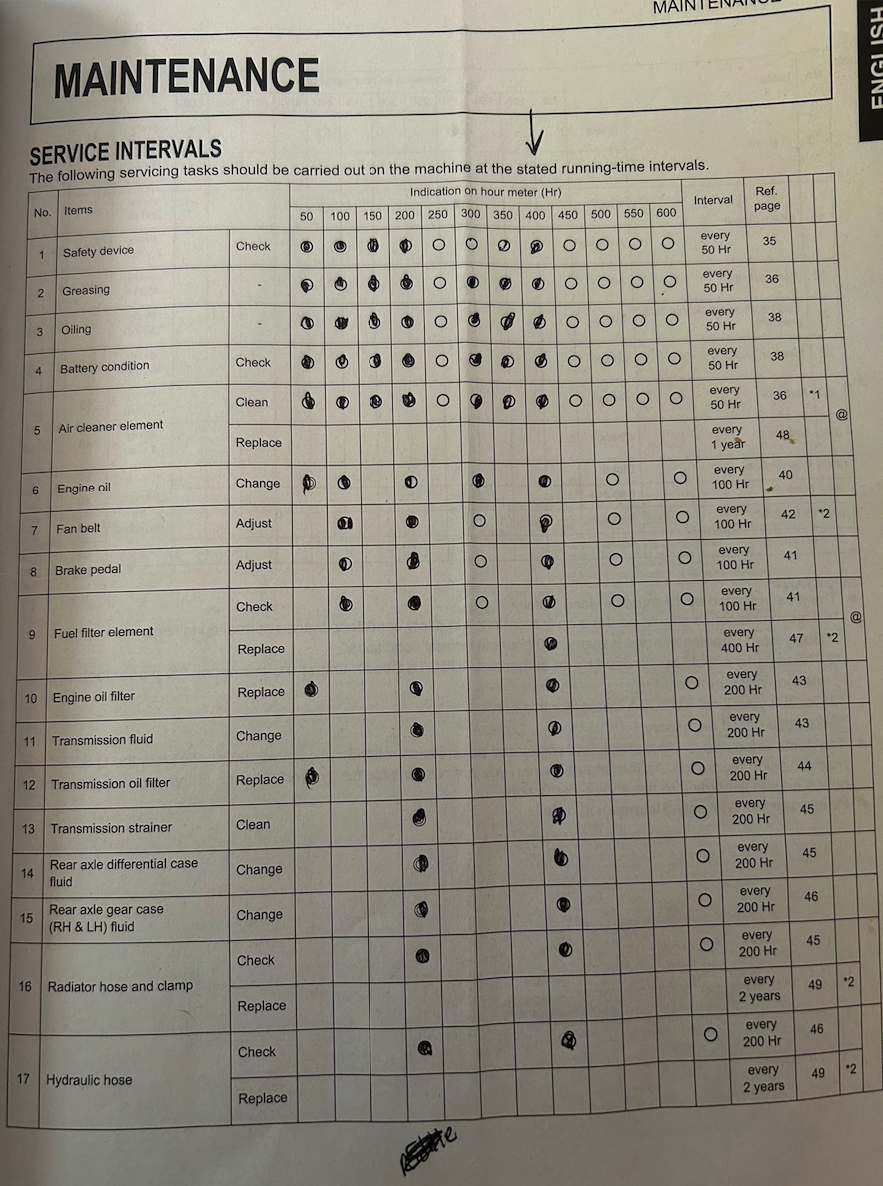

In F3060 factory recommends every 10 hour lubing of deck driveshaft and deck spindle zerks, the rest of them every 50 hours.
Thanks for making me look. I looked in the book (I just had the dealer do a 400 hr maintenance early last year and put it away in the safe).
Last year was rough for me for personal reasons, and I didn't even look in the book last year, and for some reason, I was thinking 10 on all the grease joints.
