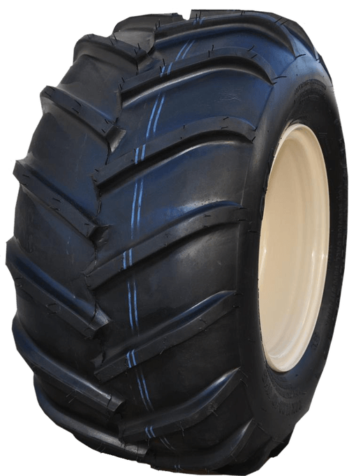

I have bar tires on my Grasshoppers, and they get great traction. The last one came with these OTR 22 Mag tires, which seem to be a little more aggressive that the Carlisle or Kenda tires.
OTR 22 Mag OTR Wheel Engineering, Inc.
