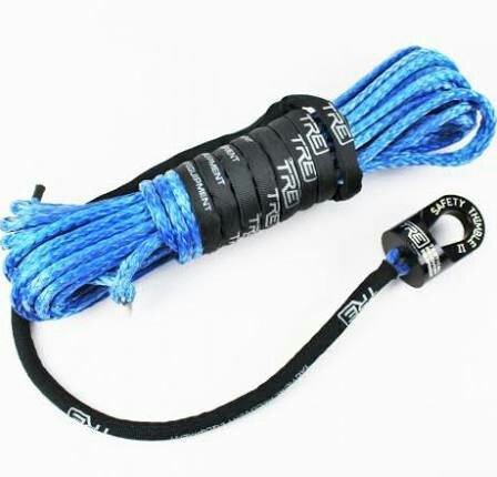

If you must pull then use winch rope! Synthetic and way stronger than chain or cable. . If it pops you just have some poly rope to pick up. Won't snap your head off!
This one is 3/8" and good for 18,500 lbs. Weighs about 3 lbs.
