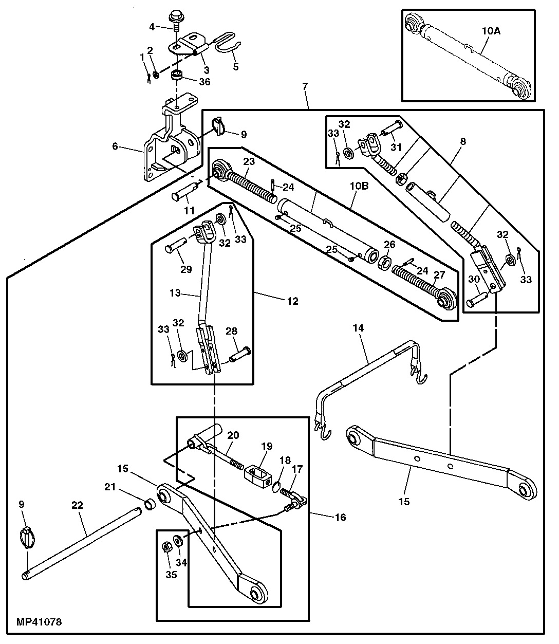

Few years ago, when I bought my 2305, some of us were complaining of to much side by side swing. Most of us fix this problem by grinding of the tip end of one of the bolt that screw in the turnbuckle, the one with the small hole and the lock ring.That would be part 17 in the diagram on post 13. You have to grind it till you get to the tread. Do the same on the other turnbuckle. The down side is you lose the ability to lock the turnbuckle with the ring since there is no more hole, but this gives you the ability to pick up more slack and there is other ways to lock the turnbuckle. I just use a tie-rap from one turnbuckle to the other. Some people also fix their sway problem by turning the loop that's in the sway bar from the horizontal position to a vertical position. If you look at Dutch picture you can see his being horizontal. In the diagram, it is the eye loop that the nut and washer #35 and 34 screws on it. I was hoping to have a better picture of my set-up, but if you click on the picture it should oversize it. If you wish to see a picture with a better angle I could take one. Let me know. Hope you can understand all of this.

npalen, the 2305 has indeed a 540 rpm PTO. I tested it on the tiller, and the tiller turns fine on it.
Henri88, I get your point/tip, and wil remove the non-threaded parts of the bolts. I think with the frontier BB the buckles are also at max. I doubt if it will be enough for the tiller though. (Dutch picture was actually my 2305, where he indicated what to switch).
   / How standard is a category 1 3ph? #34
turn the draft arms so the offset is to the middle all you have to do is pull the linch pins on the shaft and the carter pins on the lift arms. the only nuts that have to be removed are the ones that tie the turn buckle to the draft arm it will close the distance by about 6"

Ordered a hydraulic jack today (I own one, but it's still in my other house....),so tomorrow the work starts. Have to remove at least one rear wheel, because of the mower-deck-lift extension to that same shaft the buckles are on. I also had a look at a 2320 today, and saw 2 things:
- the arms the buckles are attached to seemed to be made of one piece instead of 2 on my 2305
- the eyes were in the right direction, and probably even more in the middle than the eyes on the 2305
If anybody could get me a part number for that one piece (with 2 eyes), I would appreciate it! I don't see it in the part catalog.... Picture enclosed (it's the part 23 attaches to, and axle 27 goes through). I figure it should also fit the 2305, and since the eyes are a bit further away from the arms.
I will also remove the lower lift arms and get a second hole drilled in both arms to attach the sway chain also further back.
When reinstalling I'll see if installing them vertically will also help.
Everybody thanks very much for bearing with me. I'll post some pictures of the end result when finished. Hopefully next week.jd2320-hitch.gif
See that in the JD parts picture of the 2320 the eyes are also in the right direction, as opposite to the JD 2305 parts picture.... strange.

Turned the attachments for the turnbuckles like Dutch544 showed in his (very clear!) and removed the piece with the whole in it inside the turnbuckle, and have been tilling (is that the right verb?) for 2 days now! No drilling done to the arms yet, as now I'm able to fix the attachment on the hitch. Also tried out new pallet fork, meadow aerator (is that correct?) and attachment for my trailer. So everything cool now, without modding (at least no drilling) the tractor. Next week I will test my frontier BB if I can still get it in the hitch.2013-08-09 18.26.28.jpg
