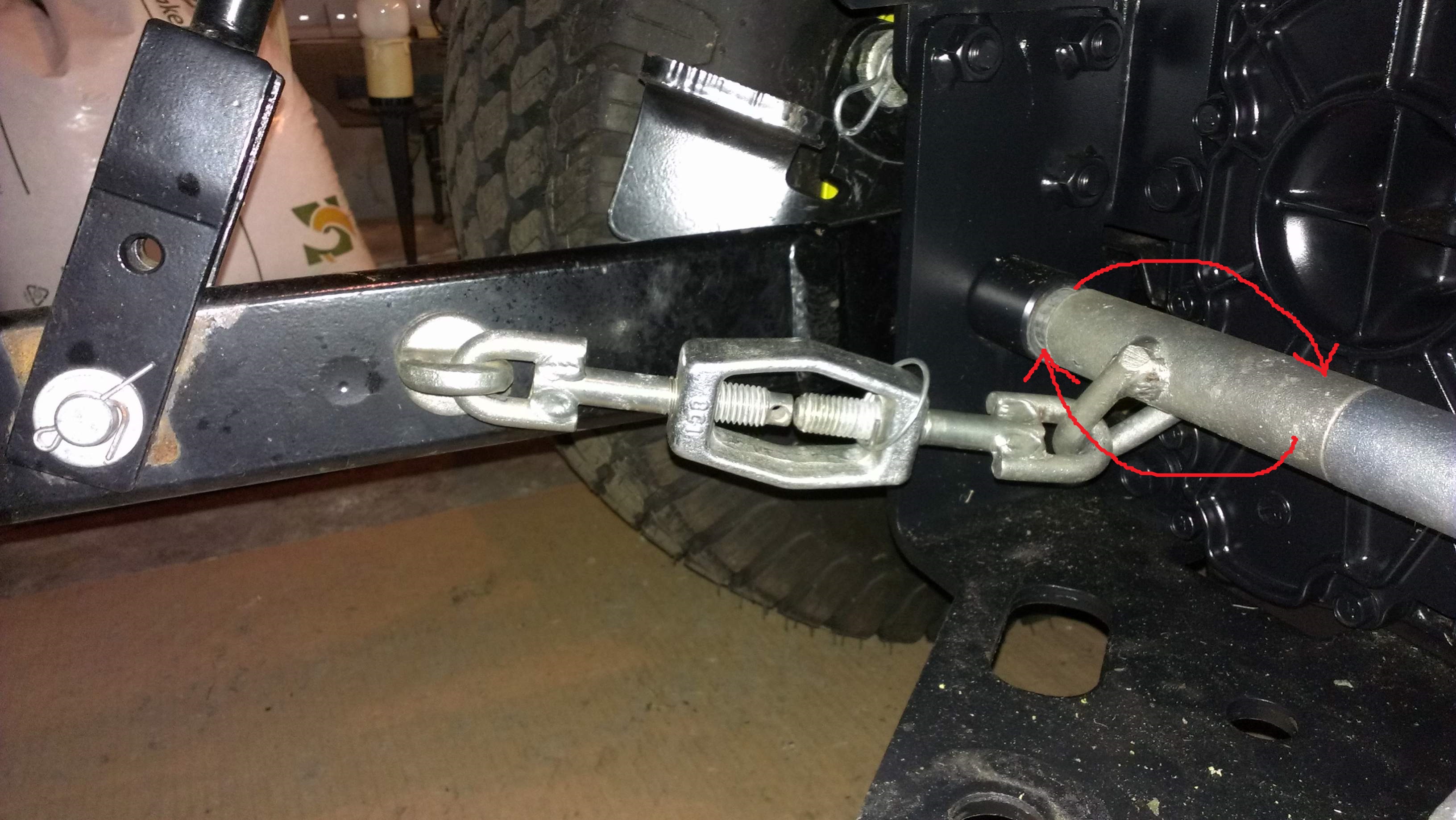

i wonder if you can just turn around your sway anchors, (part no. 20 in the parts diagram), so the
loop is further away?
i agree the "handles" can probably go or be bent out of the way, they look like guards.

Yeah GEO has us newbies very confused.... I agree with LD1, the 20" we cannot figure out.
I'll try to convince my GF to bend the handles up. Let's see how much sledgehammer is needed here ;-)
The sway anchors cannot be turned anymore, they're on maximum, and will not get any smaller. You can see in one picture, that the anchor is fully turned (did a small 'unturn' for the pic), and still the fitting is hanging down from the axle is attached to....
   / How standard is a category 1 3ph? #24
i was referring to that "axle" part you mentioned. it slides over a shaft and i was wondering
if you could reverse that part, i think it means removing a tire though to slide that shaft out.
I tried to show in this pic:
#25
Ok, very clear now Dutch445! I'll have a look later (it's raining now....). I think the wheel has to come off to access the axle though. Means no quick change than back to the original config. Will let you know!

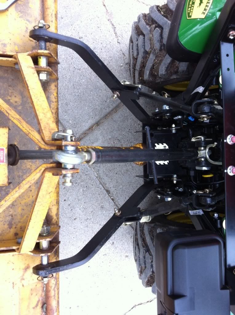

As most may not know, limited cat 1 hitches really don't like to go down to 20" cat 0 spacing. It's because the lower draft arms are short, formed, and lack the nice long swing arc of a 40 horse cat 1 tractor. Here is my cat 0 flail mower mounted on the limited cat 1 hitch of my 'R.
   / How standard is a category 1 3ph? #30
You can get extra long pins for the lift arms. That may allow the tiller to work.
