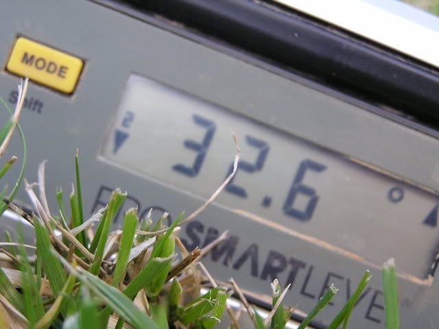

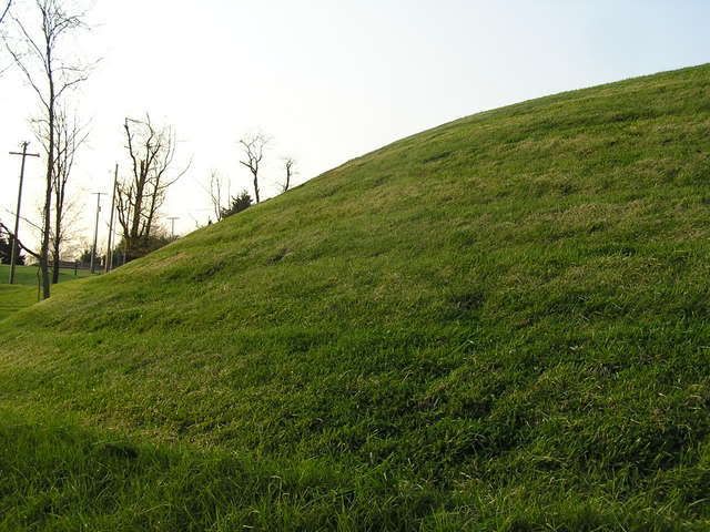

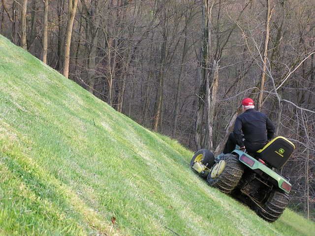

45 degrees :eek: :eek: :eek:
Now there are slopes and there are slopes. This guy was using a JD 455 on a slope that was 32.6 degrees and we all thought that thing was going to go over. (I borrowed his pictures)
I can't really imagine a tractor with a higher COG going across a 45 degree slope. I think it would just topple over.
