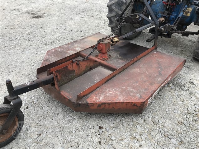

My 20-year-old Bush Hog rotary cutter has the A-frame that attaches to the 3-point hinged at the bottom, with a chain at the top that goes back toward the rear of the deck. Here's a picture of the same model I found on the Internet:
I set the top link so the chain gets tight when I back over a bank or ditch, but otherwise it just rides on the rear wheel. Works perfectly. I have no idea why Bush Hog changed to a more complex design.

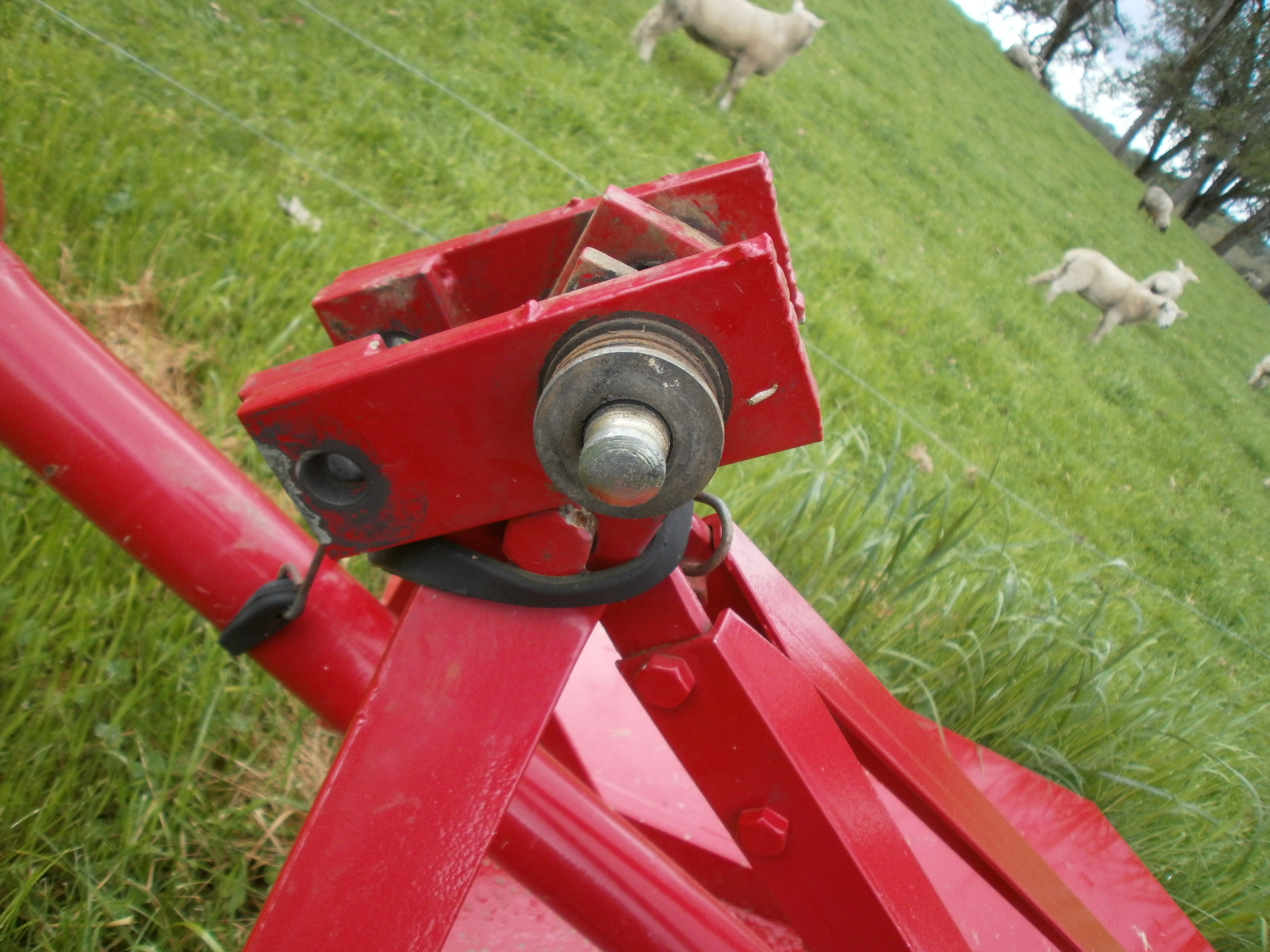

here is a photo on my old and rebuilt mower
