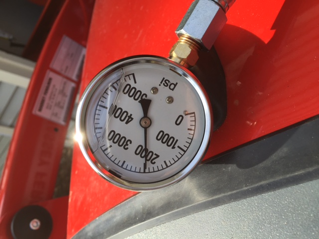

Got my gauge and checked the hydraulic pressure this past weekend. I read just shy of 2K, figured it was good enough for me, so I decided not to adjust it!

First of all, thank you all for an excellent writeup on how to adjust the pressure on the GC 1700 series. I have about a 7 year old GC2610 that I have owned for about 3 years. I have levelled about 1 acre of hilly land, rototilled the same, dug out hundreds of poplar tree stumps, and the machine is great.
Last week, moving about 3 tandem loads of dirt, I noticed the loader was straining to lift a full bucket. I remembered this thread, and went out and bought a 3500 psi pressure guage and tested my loader pressure, as per this thread. I had only about 1300 psi. The adjustment procedure was almost identical, but did not have the same bracket to remove (no 14 mm wrench needed). I was able to adjust the set screw through the opening for the mower deck height adjustment.
I increased the pressure with approximately 1/4 turns on the set screw, each adding about 200 psi, and fine tuned it to 1900, or very nearly the 1920 spec for the GC2610. I have not had a chance to give it a workout, but it surely must be better now, changing from 1300 to 1900 psi.
Thank you once again for an excellent writeup, complete with great pictures.

Quick question. The GC2610 was working fine before I assume. What would have happened to cause the presdure to drop from 1900 to 1300 ? I ask this because apparently it was not a leak . . Because if that was the case after you adjusted it . . it would have bled down to 1300 again. Any ideas or input ?
   / HOW TO: Adjust the Pressure Relief Valve (PRV) on the MF GC 1705/10/15/20 #20
I have been working the tractor fairly hard over the last few years. I bought the tractor 2nd hand, and it seemed to work fine at the time, but I didn't measure the pressure output. I believe over the last few years, the pressure relief spring may have weakened gradually, and left me with the 1300 psi. Just my thoughts, I really don't know. Now that I have the pressure guage, and the knowhow to check the pressures, I will do this annually to monitor the pump output.
As I mentioned in previous post, I haven't had a chance to give it a workout since adjusting the pressure, so I really don't know if there might be other problems with the pressure relief valve.
