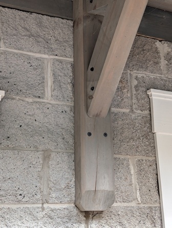

Several years ago, brother in law came. He added an awning above the garage door. Wife wants to duplicate it on the other side of the house.
Question is.... we can't see how he attached things. He didn't have a nervous breakdown.... but he's crawled into a hole and won't 'talk to the world' so I can't simply ask him.
As I recall, (and we have more) those are 12" long "log screws". Threaded 2-3 inches on the tip, rest is shaft. I can't believe he screwed those into the block itself.... is there any special anchor that you might use? Need any thoughts of epoxy or just tighten them down?
We've got the parts (that you see in the picture) already cut/stained, ready to mount. Already have the crossboards.... so this is essentially ready to go but for not knowing what he used and how he might have done it.
I'm always nervous drilling into blocks. Frankly, I would have rather NOT done it just so I can be 100% sure nothing is going to crack on me. Also, it's split face block. Wife seems to forget we won't be able to get a flat surface unless we take a grinder to it (like was done before). Again, I'm not keen on that but, it's been done and what do you say!!!
This "brow" is only two, maybe two & a half feet deep. It's just to help keep some water from landing closer to the house & splashing up on things. Thankfully, nobody will be walking on it!

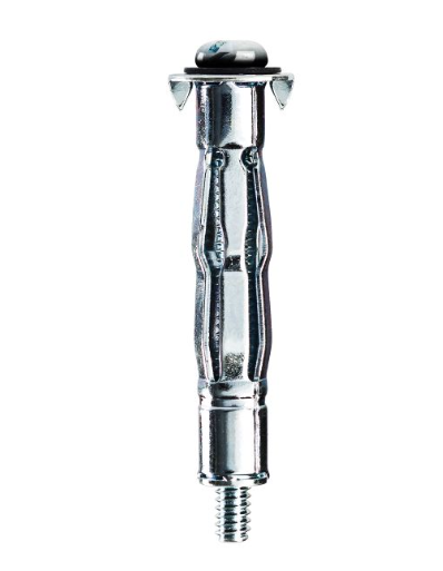

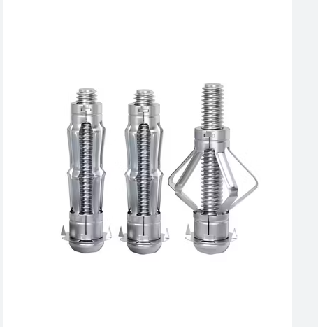

If it were me, I would try and attach to the hollow core of the block using stainless steel toggle bolts or toggle wing anchors plus adhesive. Contact with treated wood can cause ordinary steel to corrode.
I'm not sure of the weight involved but 5/16" or larger bolts would be best.

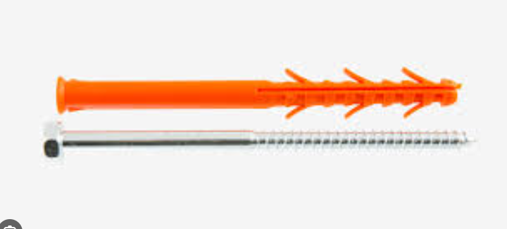

To be honest go to your local home depot and ask what they have that would give the highest strength .... google say its the link below I know someone who used it for the same exact purpose but I haven't personally used it... then there's a bunch of other examples, I would diffinatly used a insert and my guess is that's what your brother in law did.

First, what is that gray wood on top of the blocks? Is that just a trim piece? Is there a 2x12 or something capping the blocks behind it? If so, I'd get some good structural wood screws like those in the first link below to fasten the top ends of the braces. That's where the "pulling" will happen. Anchors below that will be mostly shear loads and not so much tension. Then something like Tapcons for fastening into the block below. A flathead tapcon with a little countersink wouldn't look bad.

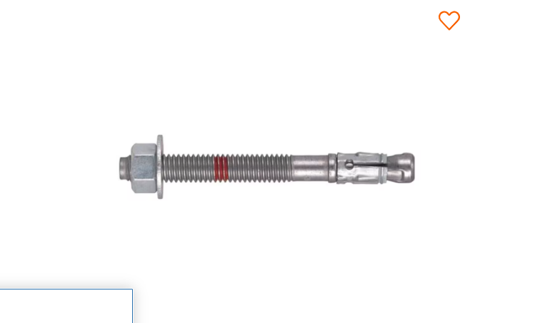

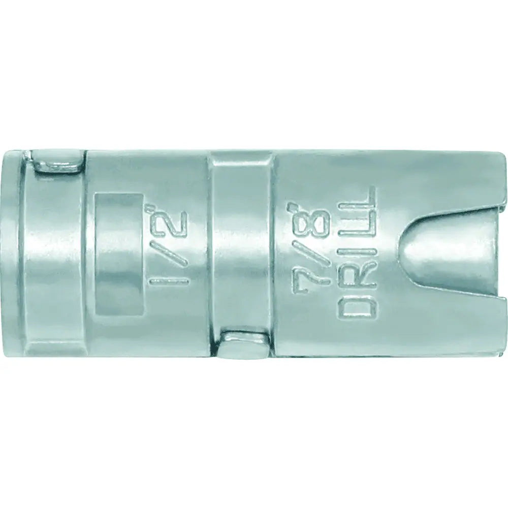

If the fastening is all done in the block, I'd use either the single or double expansion anchors in the second or third link. They're available in different sizes and are for use with machine bolts. Best would be to predrill the wood a bit for a washer. You could use either appropriate length bolts or allthread with nuts and grind off the "leftover".
The last link wouldn't be my first choice, but if the load isn't great they can look more finished than the rest. I'd stay away from plastic anchors except for hanging pictures unless they were for #16 screws. Another challenge with plastic anchors is finding screws that will work with the material you are fastening.
I'd also avoid anchors like the Hilti Kwik Bolts unless you're going into concrete. They depend too much on the tiny claws grabbing into the wall so the band expands and gets tight around the tapered bolt. Block is soft and mortar isn't much better.

Just my opinion but I think 95% of the attaching to the house is happening above the picture. The brace is pushing into the house and the wood you want to screw onto the house is spreading out that pressure over more bricks. So the only thing the 2 screws are doing is a little bit of shear force side to side and possibly keeping the wood from warping and pulling away from the house. The important part, like chim mentions, is the wood at the top of the picture and what is behind it and above it. The screws at the bottom going into the brick are kinda cosmetic.

I’m thinking same thing. Attach to wood at top.
