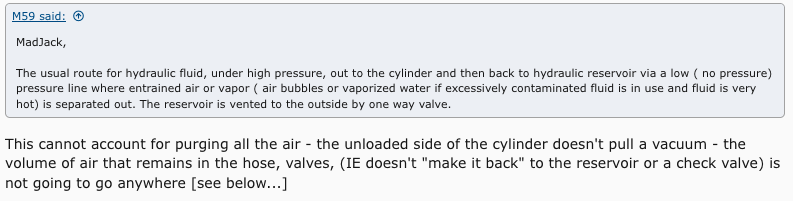

MadJack,
The usual route for hydraulic fluid, under high pressure, out to the cylinder and then back to hydraulic reservoir via a low ( no pressure) pressure line where entrained air or vapor ( air bubbles or vaporized water if excessively contaminated fluid is in use and fluid is very hot) is separated out. The reservoir is vented to the outside by one way valve.
This cannot account for purging all the air - the unloaded side of the cylinder doesn't pull a vacuum - the volume of air that remains in the hose, valves, (IE doesn't "make it back" to the reservoir or a check valve) is not going to go anywhere [see below...]
Air can get pushed past the seals whereas fluid cannot. Do you think dealers or the factory bleeds loaders when they install them?
^ UNLESS there is another path out. I cannot say definitively that @kennyd 's proposal is INcorrect - but it seem suspect to me.
from a seal manufacturer's site "It is also important that displacement hydraulic cylinders are bled before installation"
additionally, a seal might behave differently per direction: the cylinder seal is very very good at keeping high-pressure fluid IN the cylinder - this says nothing about it's ability to keep air out such as when a vacuum is pulled when a cylinder is forced one way faster than the pump can deliver, as @npalen pointed out. The seal design has some similarities to a one-way valve in this regard.
All that said, as a practical matter Kennyd could be correct, the (relatively cheap quality and/or well-used/worn) cylinders used on most of our tractors could in fact let high-pressure air out. Things flow differently depending on properties & state (think hydrogen at different temperatures, a-la recent SLS rocket launch scrubs).
Now, disclaimer to the above: I design things for a living, but not these things, so the above is me trying to parse easily available information - possibly incorrectly :). YMMV.
