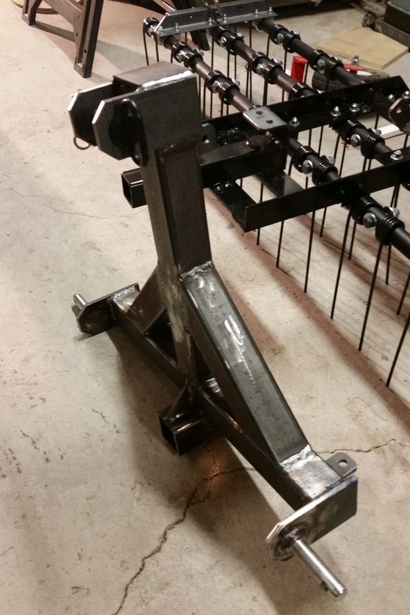

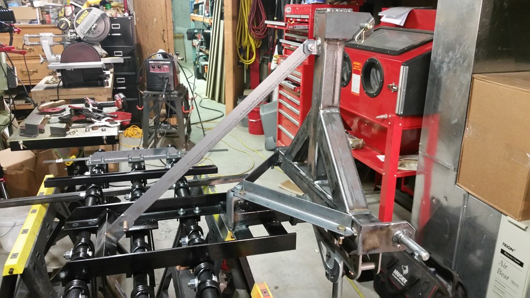

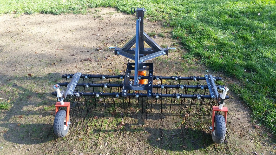

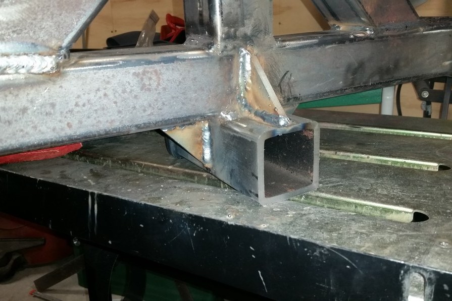

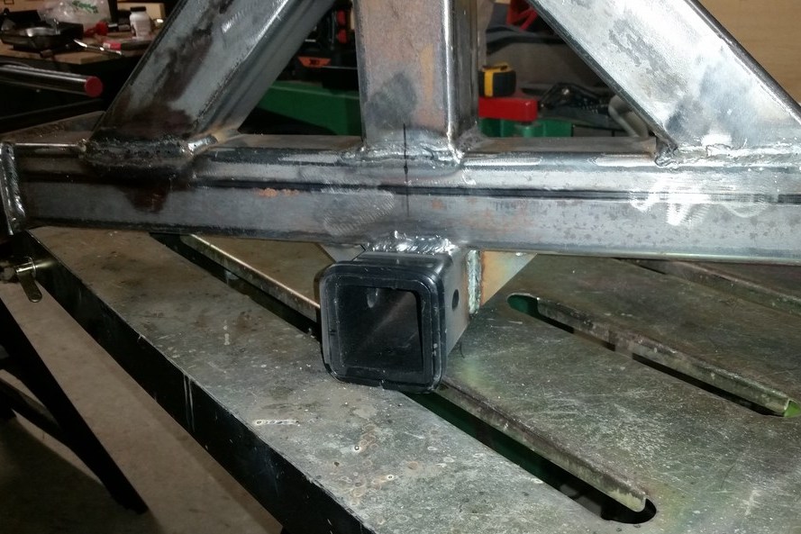

If you want to get creative, build a "Universal 3-PT Mount", and then the custom portion for the spray tank. I built a York Rake a couple years ago with a fixed 3-PT mount. The mount was the time consuming part to fab. Then I decided to build a heavy duty dethatcher and went with a design that would allow the mount to accept other accessories. Pretty much just copied what I did for the York rake, but mounted a standard hitch receiver on the bottom. There are tabs to bolt on stabilizer bars to keep whatever you mount fixed. The guide wheels in the last picture are off the York rake.
Here's a few pictures of the 3-PT mount...
I like the way you MIT fellas think...I spent some of my childhood in Cambridge (circa 1942) when dad was attending Harvard and MIT building RADAR for the US Navy. Then, as an adult, I worked for a company located in Cambridge...miss Legal Seafood and Jimmy's Harborside Inn.
I already have a sturdy 3 pt 2 inch receiver attachment so, I'm half way there. So, I'll fab up the sprayer tank carrier with a removable seat for the co-pilot, maybe a stereo outfit for the co-pilot (daughter).

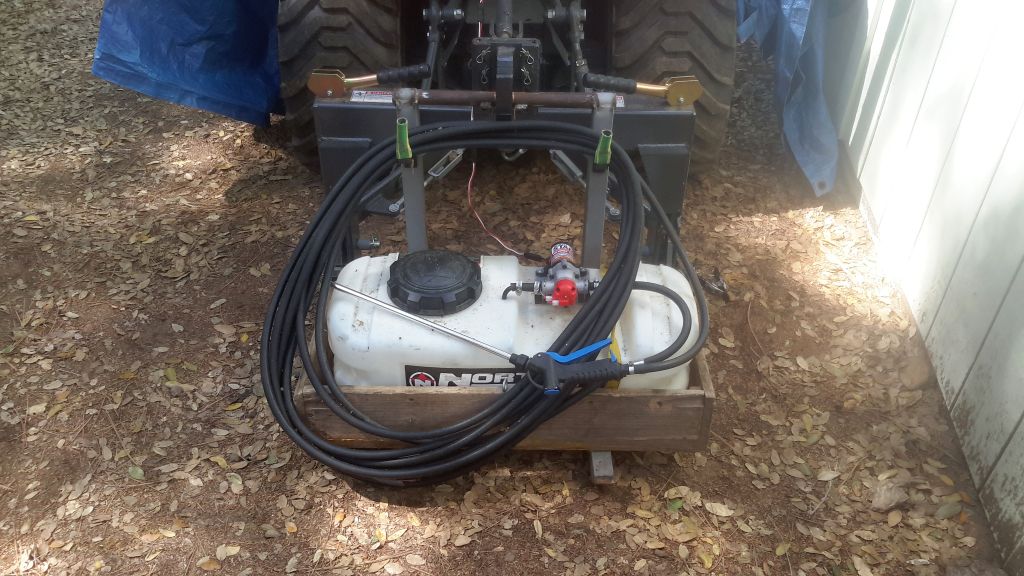

A little late getting back to the party with pics....
This was just a quick fab to mate with quick hitch.... But receiver method mentioned above would be very valid also...
But if you have 3PT receiver hitch and can't weld.... Dont think I would put co-pilot on it though..

Not my choice of colors either but when major manufacturer chooses wrong colors you are right, rattle can can change all that....
