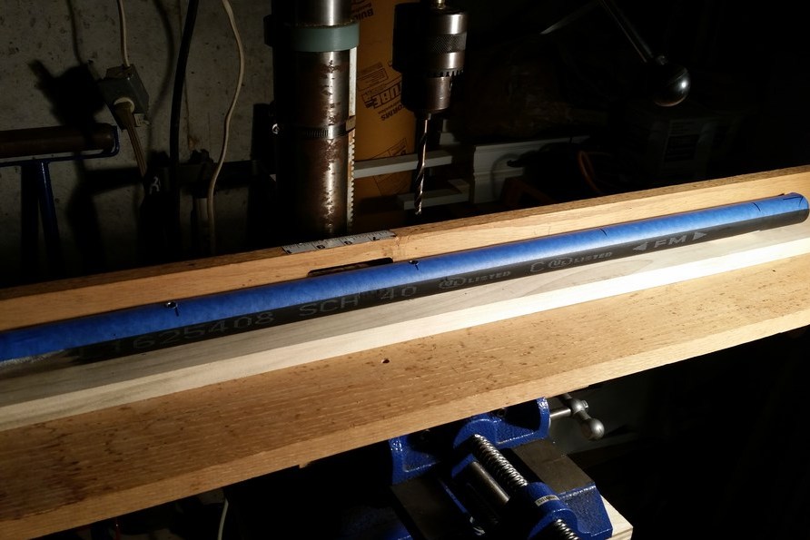

If you want to get creative, build a "Universal 3-PT Mount", and then the custom portion for the spray tank. I built a York Rake a couple years ago with a fixed 3-PT mount. The mount was the time consuming part to fab. Then I decided to build a heavy duty dethatcher and went with a design that would allow the mount to accept other accessories. Pretty much just copied what I did for the York rake, but mounted a standard hitch receiver on the bottom. There are tabs to bolt on stabilizer bars to keep whatever you mount fixed. The guide wheels in the last picture are off the York rake.
Here's a few pictures of the 3-PT mount...
How did you drill the holes in the round bars so that they came out even?
   / How to build a 3 pt sprayer rig? #13
I have a long fence/guide that I mounted in the drill press vise which supports the pipe. I took a 4" bolt and cut the head and threads off to make a pin to stick in the first hole I cut. I have a magnetic angle gauge that I put on the bolt to ensure I was level. I guess I didn't take a picture of it.
Here's the gauge I bought at Harbor Freight...
Digital Angle Gauge
