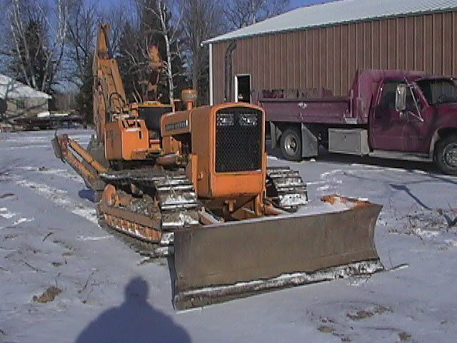

I have a '68 JD350 with QT backhoe. Bought it in '02 for $10K and still have it. Hard to sell it as friends, neighbors, and relatives request dozer work /forums/images/graemlins/grin.gif
Only expense beyond a little fuel and oil changes was an injector pump rebuild for $500.
One consideration to keep in mind is mobility: transport, getting it unstuck, etc.
The JD350 has parts availability at the local ag dealer, newer larger dozers are stocked at the yellow paint dealers. For me that would be an extra 60 miles on a round trip.
I have the 6' PAT blade power-angle-tilt. Mostly do landscaping, trail building and lot clearing. The blade is 1 yard rated but I've pushed 3 yard piles of clay.

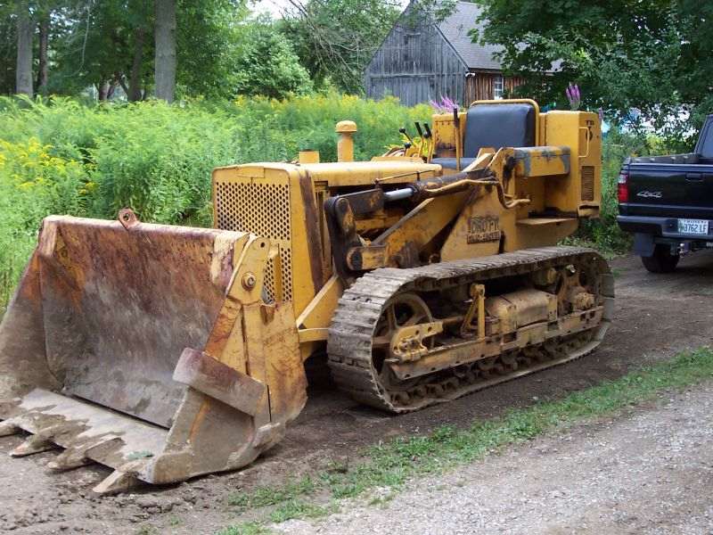

I would agree with getting something with a 4n1 bucket. You get the best of all worlds, a grapple, a bucket, and a push blade.
My 1963 IH TD6 with a Drott loader and 4n1 bucket weighs in at 15,000 lbs and has a breakout force of 18,500 lbs. With a 55 hp non-turbo engine it will do just about everything except dig out really big stumps with one push.
The biggest problem with old machinery is parts availability. Wih any dozer you buy, make sure you get a good undercarriage which includes sprockets, rails, pins, rollers and tracks. Otherwise, I hope you have a big fat wallet.

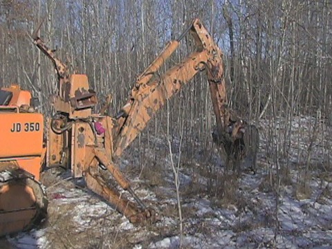

#93 backhoe has a large quick connect hose to the dozer hyd. The valves are all mounted on the backhoe along with the flip down seat. Seat frame is what is sticking up in the pix. I keep the seat in the barn. You can see the 2 vertical plates on the bh fits over 1" plates on the dozer hook & pin style. Makes for a 2 min attach/detach.
Deadending the hose will stall the motor.
Motor is a 3 cyl diesel 152 cid 40 hp with a power reverser. There is a gas version. Used in the 1010 ag crawler & wheeled tractors.
