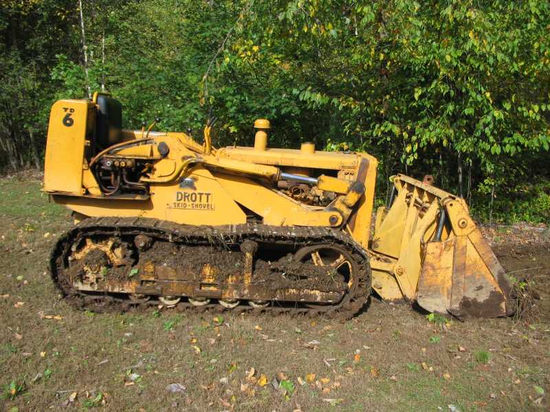

Way way too light. You are talking Komatsu D21 size which is smaller than a Cat D3. Pulling up hardwood stumps will be quite a chore. My 15,000 lb TD6 has problems with anything over 12-14" but I can spend time and dig around the roots to get them out. A lot depends on soil conditions.
Based on what you said, you probably need something in the 20,000-35,000 weight range, with 10,000 to 15,000 lbs being a minimum. Getting something too small will be a big disappointment power wise.
