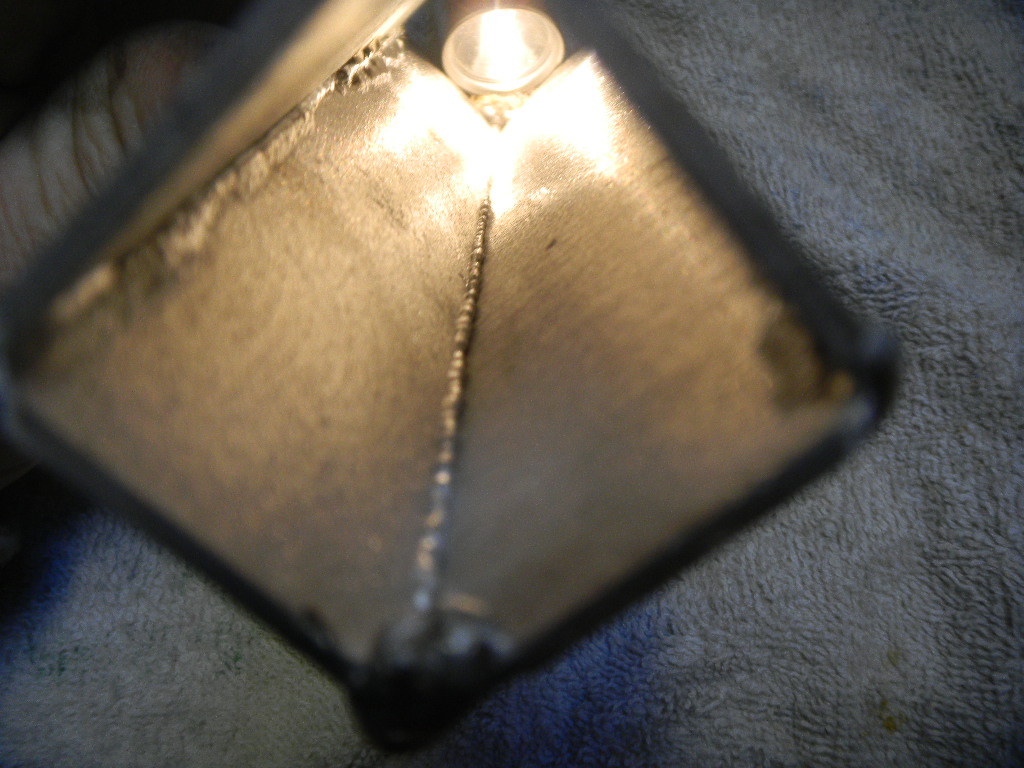

First two pictures are on 1/16-inch thick aluminum. With .030 wire.

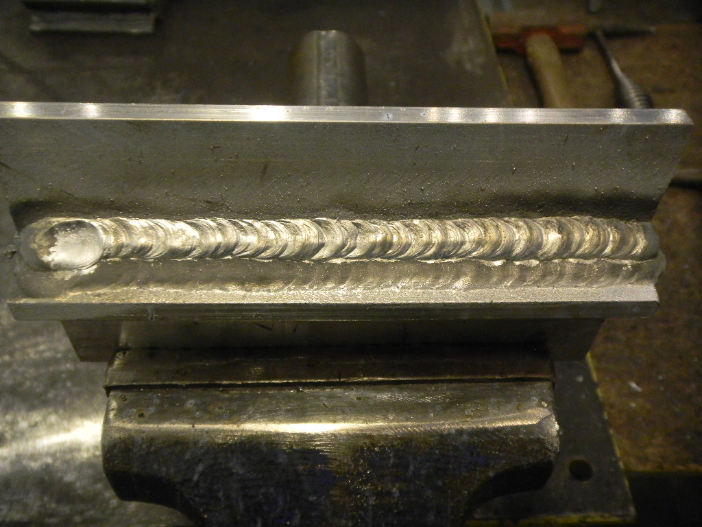

Third picture looks like maybe 1/4-inch thick aluminum. With 3/64 wire.
