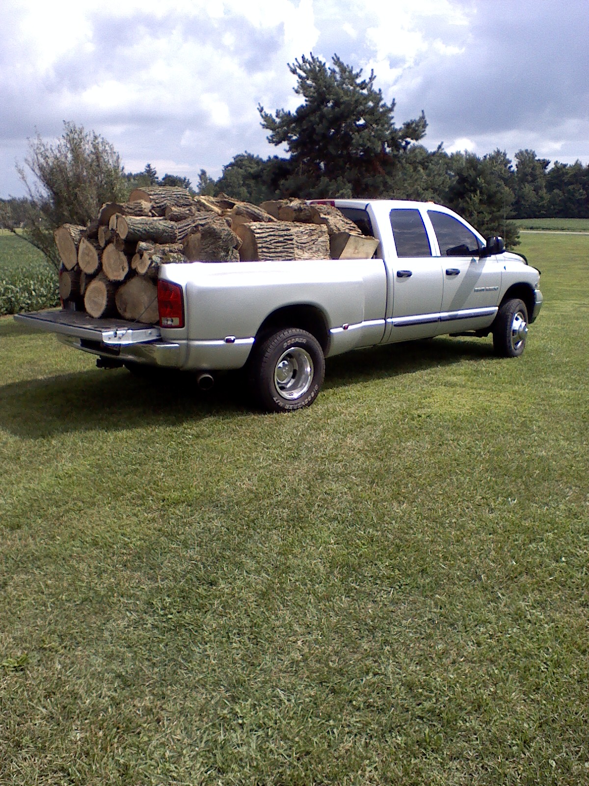

I have always read that a full stacked cord of wood would normally contain ~80 cf of solid. That is the number that all of the charts that calculate "what does a cord of _____ weigh"
Not a fan of face cord either. But It is possible to put a full cord on a puckup, if you know how to stack.
View attachment 493338View attachment 493339
But I did make some ~10"-12" high side boards to make loading exactly 1-cord a bit easier for delivery.
View attachment 493340View attachment 493341
Well I saw your reference to 80 cf which corresponds to the Oklahoma study that used a range of 60-90. I had split that difference and used 75 cf. But I took another look at my post where I said 1.33 of the log CF would give you the cord volume. I was wrong- I got tangled up in mixing up 128 cu ft as a cord with "1" meaning a cord.
If I use your number 0f 80 cu ft = 1 cord of split wood, or 128 cu. ft., you solve for " X" 80 x "X"= 128 or 80X=128 or 128/80=1.6 as the multiplier
Using my number of 75 cu ft= 1 cord we have 75 x X = 128 or 75X= 128 or 128/75=1.7 as the multiplier
either number will give you a good yardstick to convert a log-again subject to how small you split it.:drink:
