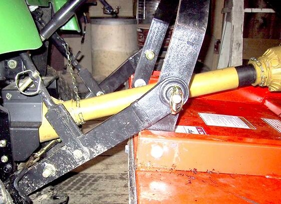

Thanks for the link johnmiller3 - excellent reading and I learned a couple things I had set up wrong.
And, yes Bird - no draft control here.
Anyway, I had my top link adjusted wrong. I had it pulled tight so the deck couldn't "float".
I also looked again, and can't seem to be able to use the check chains as suggested in the link. My PTO shield sticks out too far.
I took some photos of the hitch set up with descriptions and questions (pictures say 1000 words?). If you guys would be so kind as to indulge me, please visit the link below (click on the thumbnails for the larger photo with descriptions).
hitch setup
   / How to "carry" a rotary cutter? #9
Re: How to \"carry\" a rotary cutter?
Check the A-Frame on your rotary cutter… is this assembled correctly? (It should be perpendicular to the deck, not “tilted back”???
Also...You Don’t want it adjusted this way… Look at your PTO shaft near the cutter deck...

Nope, can't do that either. /forums/images/graemlins/wink.gif On those without position control, the lever is centered; move it forward and the 3-point lowers and continues to lower until the lever is centered again or it is all the way down. Move it to the rear and the 3-point raises and continues to rise until the lever is centered again or it's all the way up. The distance you move the lever only increases the speed with which it raises or lowers; no stop possible like tractors with position control.
