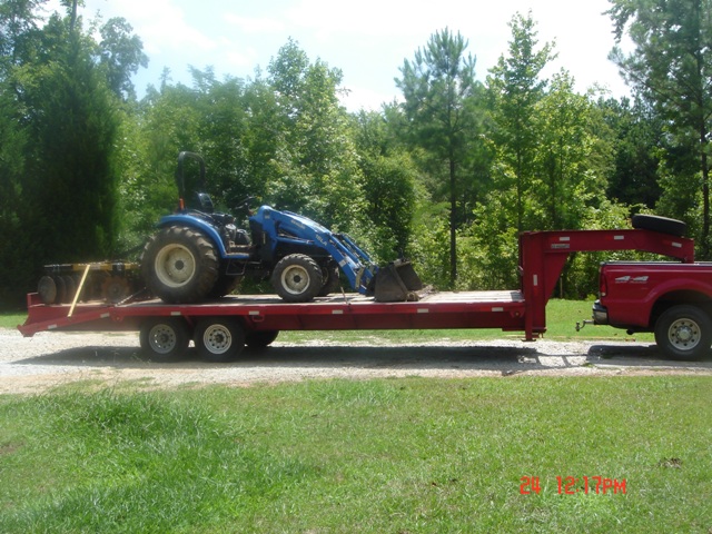

Also, I don't like fenders. They are always in the way to me. You can't load sod, bricks, concrete blocks etc. over your axle with pallet forks. I may get flamed for this, but it's just my opinion. If you do get a trailer with fenders make sure a compact track loader and a mini-ex will fit between them. I learned that lesson the hard way.
Here's a couple pics of my gooseneck. It's a North Alabama brand 20 + 5 with 7K lbs axles.
Hope this helps with your question.

Big State here in the Houston area tells me the first axle should be at 60% of the trailer length. Second axle follows as the spring set needs. So, just remember the 60/40 rule regardless of trailer length.
Your trailer 'looks' like it would be balanced, but I think you'll find out as others have said, axles centered will never load right.

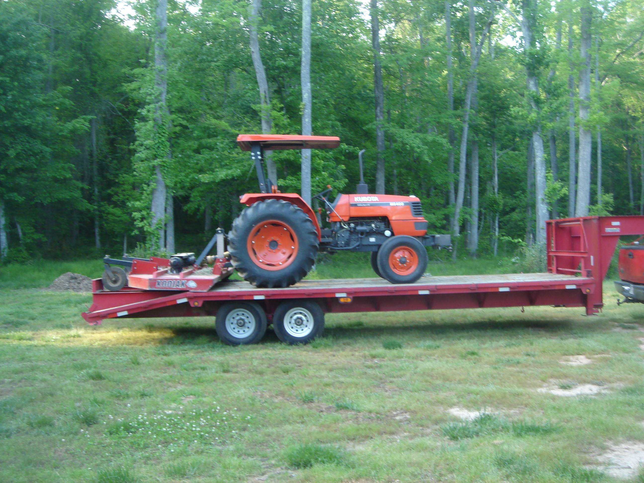

Here's a pic of the trailer as you can see the axles are about centered on the trailer. . . is that going to be a problem?
Thanks again for all the help
It almost looks like that trailer was originally shorter, the back end added on. It is hard to tell . . . . .
   / how to center tractor on trailer #18
I would take the tractor and trailer to the scales and get an axle weight on every axle then post back with that so that we can crunch the numbers. Don't forget to get the tongue weight on the unladen trailer. Otherwise everything is just a WAG, not even a SWAG.
If you backed on and dragged your cutter on behind with the FEL bucket above it, you should be able to fit it and get the balance right. Or just put the FEL above the tongue like someone else said, it's wasted space anyways.
