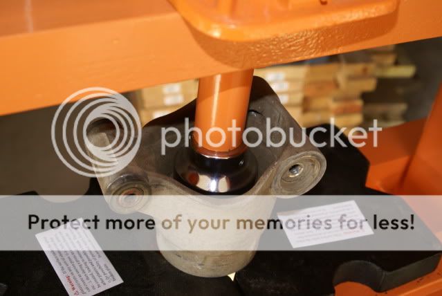

Remove old U-joint. OR....Measure diameter of bearing caps and width of cross (inc bearing caps) Head to NAPA. Go home and install. I use a hydraulic press, but a vice is just as good. Hammers work in a pinch.

I haven't done this in awhile, & am having problems getting the old u joint out of the yoke on my Howse brush hog driveshaft. The old ring-type PTO end froze up & had to be destroyed to get it off. While I'm replacing the front yoke, I might as well replace the u joint. How does it come outa there?? I have pulled the circlips & pounded out the universal to a point it feels solid & won't move anymore, but it isn't clear of the other side of the yoke.
This is the way. Beating with hammers may get them out, but bad to get the new one in. Vises can bend, ask me how I know.
