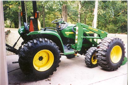

Not a major problem, just use a jack under that axle, and raise or lower it to match the height of the wheel. Some slight jockey'ing around to line up the lug bolts, but not a difficult task. Certainly no need to get a forked lift to raise the tire, IMO. Watch where your hands and fingers are at all times, and have the wheels blocked to keep the tractor from moving, and have safety blocks under the frame to "catch" and hold the tractor if for some reason the jack fails.
But if you are not sure just what you are doing, and why, then I would suggest letting someone else do it.
Attached is a pic of when I changed both rear tires, loaded, from side to side. I used a jack and blocking. One wheel has been removed and "waits" to be put on the other side, while the right rear is leaning in place waiting to be bolted on. I didn't do this carelessly, as I didn't want that tractor sitting on the concrete with no way to lift it back up.

You described pretty much what my game plan was, ie move the tractor up & down to line up with the wheel. Not having done it before, I guess I was looking for confirmation that my plan was the "right" & safe way. I probably should have stated my plan and asked for comments, instead of "duh, guys how do I put a tire on?"
I feel I'm reasonably well equipped, choice of floor jack & bottle jack, jack stands, level garage floor, and wheel chocks.
