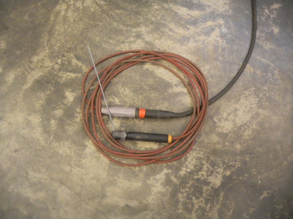

   / How to check out used Miller XMT 350 cc/cv #12

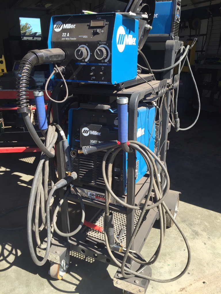

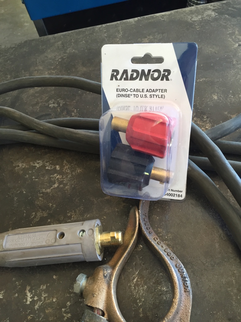

Steve. If you haven't done so already, check the XMT to see if it has Dinse OR Tweco style panel plugs. Miller offered them either way. My two machines were configured differently.
Top photo, the XMT I kept with Tweco style connectors.
Second photo 1/2" Dinse style with Dinse/Tweco adapters.
I have Tweco everything (whips, extensions, tig torch adapters etc) except for a few machines that have the Dinse panel plugs.
I'm not familiar with the connectors on your Dialarc. I would just buy two matching male plugs and make short pigtails with female (your choice) 1/2" Dinse or Tweco and standardize. Premade cable assemblies are cheap on eBay.
And I do the same as Shield Arc. 1/0 for everything except whips.
