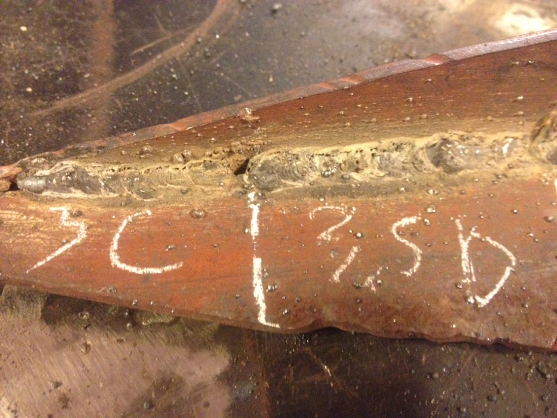

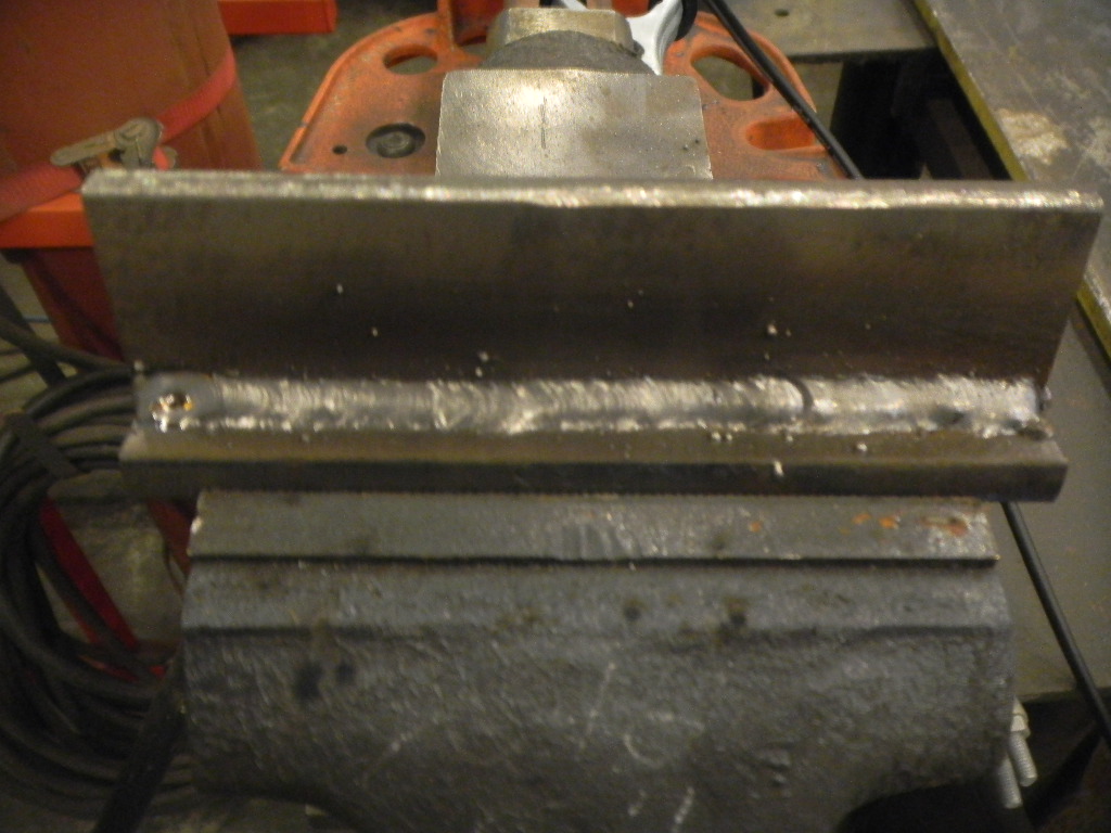

Dave remember that 120-volt Mig welder of Roadhunter's I had. Here is one of the first welds I made with it. See how the crater / stop is full? I shortened the stick out, and backed up some.

Shield. I took a couple more pics today. Didn't get to do any welding today.
   / How to choose flux core wire?
#26

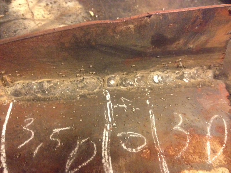

Oops forgot the picture.
#27
Second picture.
   / How to choose flux core wire? #28

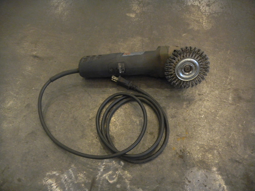

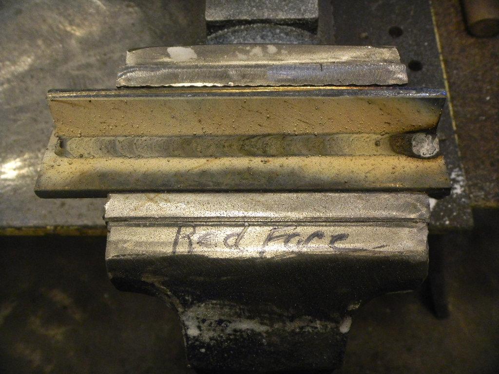

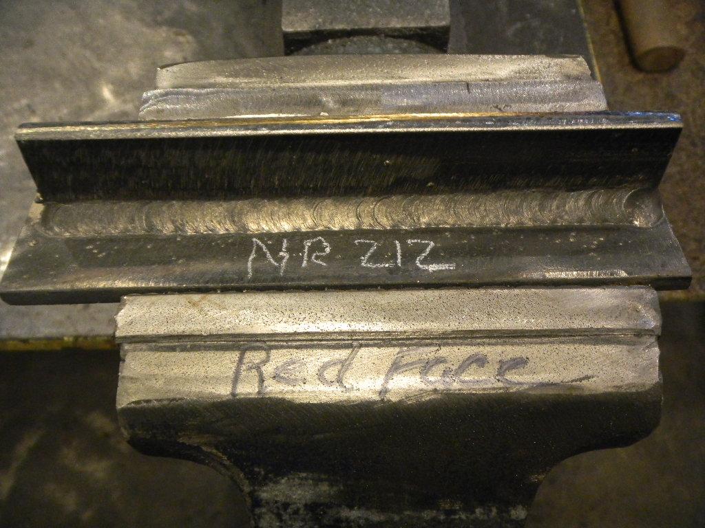

It's really hard to tell with all the slag still on the weld. Do you have one of these?
Here's what they do to self shielded flux core slag.

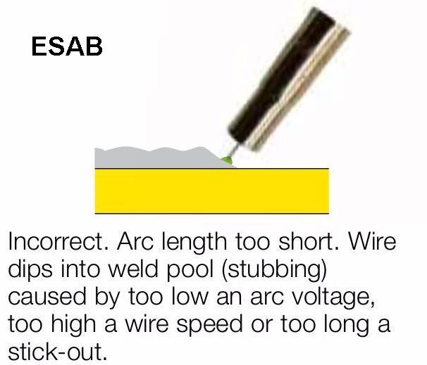

Here you go Dave. I found this in a ESAB pdf file. I don't know how to post the whole file, so I just copied and pasted it.
